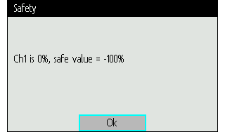

5.1. Safety System¶
Deviation has a safety system to prevent starting up in a dangerous state (for instance spinning up the main rotor of a helicopter accidentally). The safety system works by verifying that specific conditions are met before starting to transmit to the model. By default the output channel associated with the throttle stick must be minimum. The Deviation firmware does not include a mechanism to define new safety conditions, however, they can be added by directly modifying the model.ini file. While the safety message is displayed, the transmitter will not communicate with the model. This message may appear either when initially turning on the transmitter, or when switching to a different model. The message will disappear automatically once all safety conditions have been met or when ‘OK’ is pressed. In either case, Deviation will start communication with the model once the dialog is dismissed.
The safety values are in the ‘[safety]’ section, and the default looks like this:
[safety]
Auto=min
The ‘Auto’ value can also be any channel or input name, ‘Ch1’, etc. The ‘Auto’ tries to guess your throttle channel number. If that isn’t working, and you’re getting an unwanted warning, then changing it to ‘Ch1’ (DSMx protocols) or ‘CH3’ (most other protocols) will fix the problem. The ‘min’ value can also be ‘max’ or ‘zero’, to test that the channel or stick is at the maximum value and 0.
