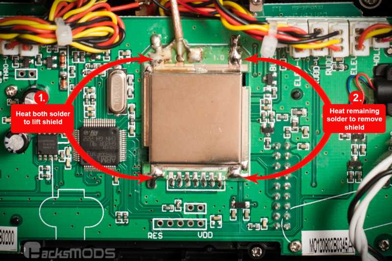

I recently posted a how to in 7E development and was not satisfied by my explaining and conclusions. So by trial and error I perfected my technik with a few cordless pones.
Here goes nothing: read before doing!
Read my first post, I am sorry I had to do it that way.
Get the module stable and have good lightening (you need some kind of solder holder board or something) to get away from any surface. Then use a wide pair of tweezers to get a grip of the shield, or drill some holes ore just something in-between in the opening of the corners.
With the other hand light up your storm lighter (1300C).
Heat it on top in slow circular movements. With the exhaust point of the outer blue bounder(approximately 6-9s) depending on soldier flux and of course heat. You can use flux around the sides of the shield.
Suddenly it will just release, then lift it of in a confident move.

Did the diode mod. Thanks for the help. Here's some photos.
Short the two points to complete the circuit.
Blog post with the large photos. Feel free to use.

Replied by spiegel on topic Removing shield and diode 7E for better reach
With my all thumbs soldering skill, I removed 4 diodes as the below picture. What can I do? Do I have to pay for another 7e or shorten 4 diodes?
09 May 2013 14:15 #9751
Replied by PhracturedBlue on topic Removing shield and diode 7E for better reach
well, that is a first
I need to look over the circuitry to figure out your options.
You could always buy an 8S upgrade module (if they still sell them?) That is a reasonably easy install to replace the stock module (but you also need to get an antenna)
