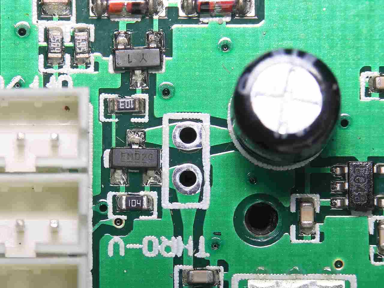

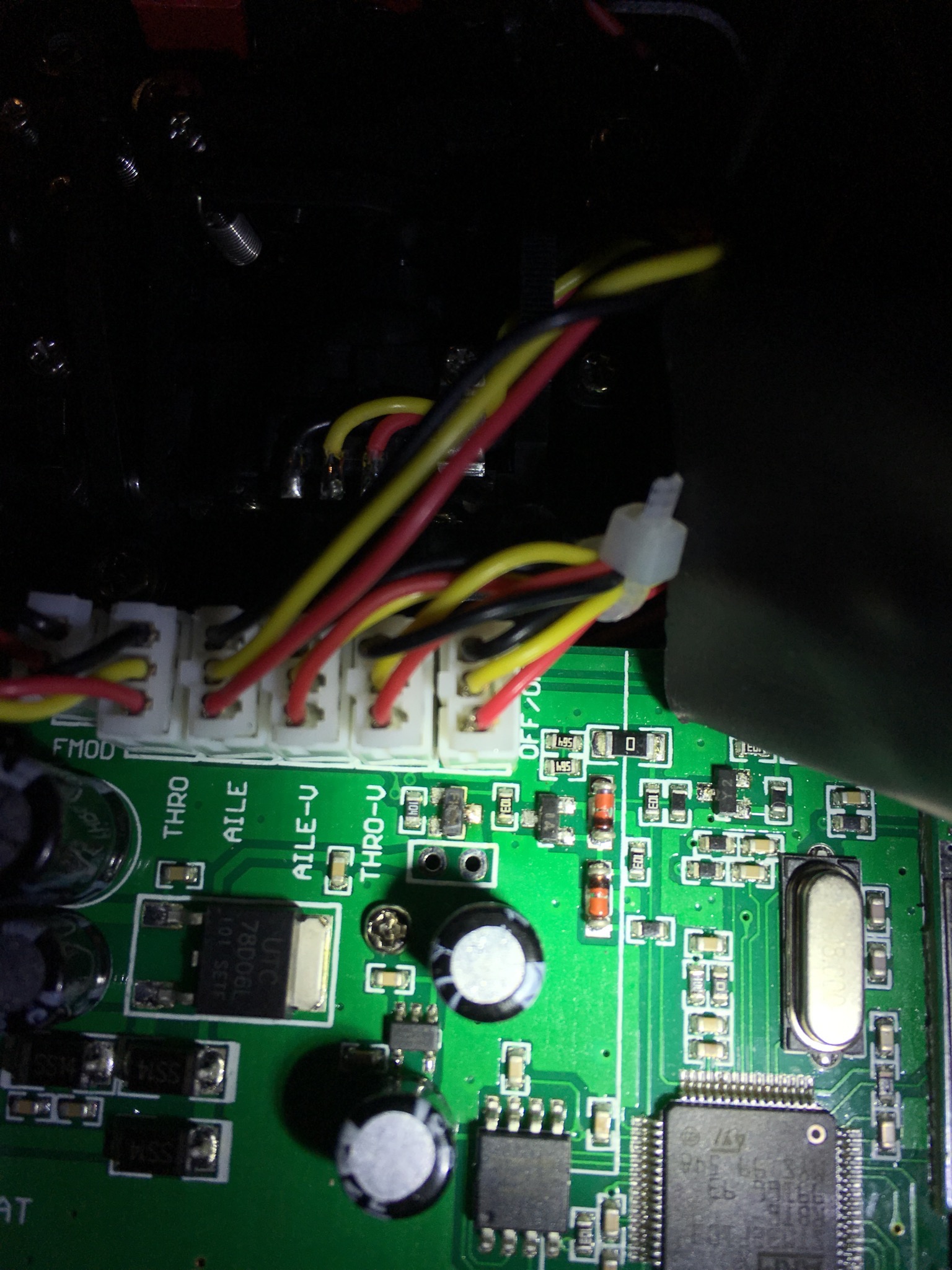

Helped a friend install an NRF module in his Devo 7E, the previous owner had hacked in a module using twisted wires, DuPont connectors, booger solder, ect. We tested with everything loosely put together, and it worked fine, but when he bolted it up, he pinched a wire or something and let the magic smoke out. Damage to what looks like a FET was too much to read the info on the chip, so I was hoping somebody can help ID it so we can get a replacement.
It's located under the pitch/roll sticks, on the left as you look at the opened up Devo.

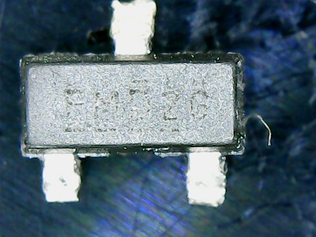

The chip is shown with red arrow, close up view below.

01 Jun 2016 05:08 - 01 Jun 2016 05:17 #49701
Replied by PhracturedBlue on topic Devo 7E main PCB component ID help
looks like an FM02G (or FMO2G) transistor.
Based on this and looking at my Tx, it bridges the power jumper, and so is likely a power P-FET.
My Devo8 used a
IRLML6401 which is probably equivalent, since the power circuit on all Devo radios is basically the same.
You can use any PFET that can sink more than an amp and has low Rds. I used a generic to92 p-fet from radio shack when I blew that exact same tx on my devo8.
Just checked and looks like I used a BS250 which is in no way an appropriate replacement as it has terrible Rds and low power sink, but still it has been running fine for a couple years now. So find any old P-fet and stick it in there

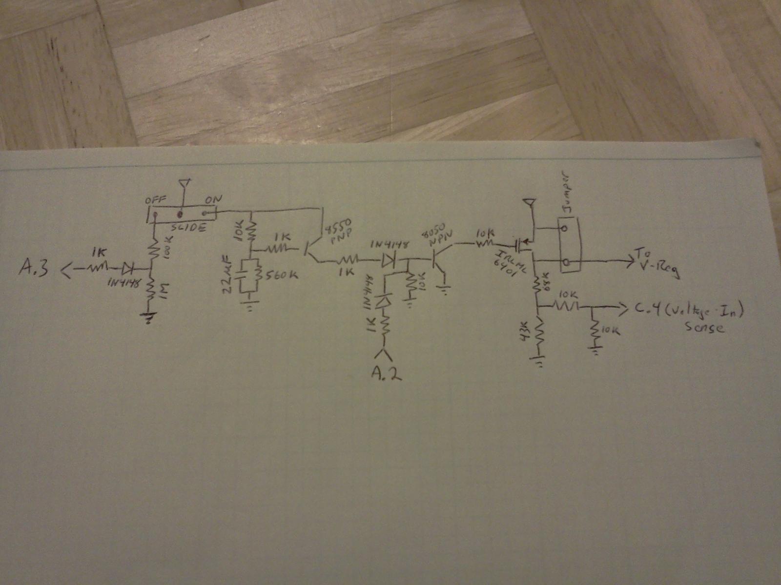

BTW, the power circuit for the Devo8 is here:
www.deviationtx.com/downloads-new/catego...power-switch-circuit
The 7e wil be basically the same

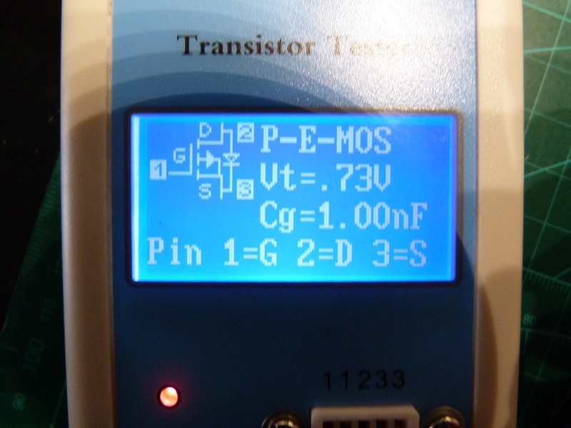

I've desoldered the Mosfet and threw it onto the transistor tester.
PNP Mosfet.
Screenshot attached.
PNP Mosfet.

01 Jun 2016 12:22 #49734
Yes, that should be fine. It is the lead-free version of what was in my Devo8. The voltage on a PFet is always negative, because it is measured from drain to source.. Make sure you do not use more than a 12V battery/charger though as I believe this transistor is before the LDO.
Fyathyrio wrote: OK, if I've understood everything properly, these should work?

So I've blown the same FET on my devo7e and one of the guys on RCGroups has offered to send me a replacement. I was wondering, in the meantime if I could continue using it. I can cycle the power by unplugging and plugging the battery pack in and everything works normally. Will this cause any sort of damage? Am I best off not using it until a new FET is installed?
05 Jun 2016 04:26 - 05 Jun 2016 04:26 #49931
if you blew the power fet, the transmitter really shouldn't turn on at all (unless it blew in a shorted condition, which would be an odd way for a FET to fail). Are you sure this is the issue? You can apply a jumper across the FET (There are pins near by) which will result in it powering up when the battery is attached, and this is perfectly safe except that you need to manually save the changes before unplugging the battery (assuming you are running Deviation. I don't know how the stock firmware reacts to this)

The bypass is the two holes directly below the p fet, right?
05 Jun 2016 20:21 #49991
yes
