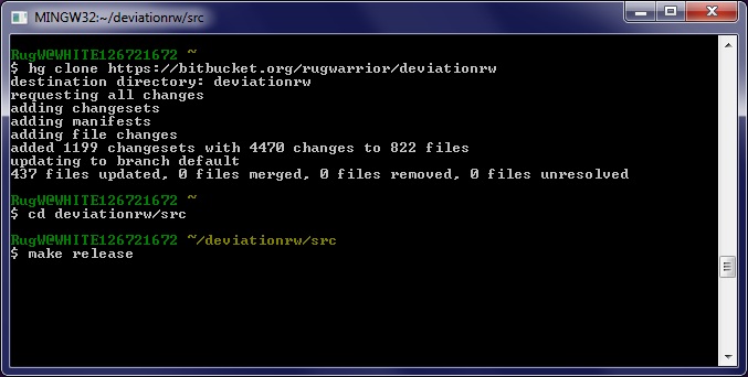

New version v1.2 released! :woohoo:
MinGW based DeviationTX build environment v1.2 has a nice documentation and there is an installer B)
It should work for x32 and x64 based Windows systems and was tested on Windows 10 x64 building the latest repo plus emu(s).
It is fast and easy to edit your repo, test and edit language files with the emulator or just build the latest version of a repo before someone else will do it ;)
Everything will be extracted to C:\MinGW (also the toolchain). So it does not matter if you already have a toolchain installed :)
Use "hg clone bitbucket.org/deviationtx/deviation " as this is the latest repo :whistle:

31 Dec 2012 12:38 - 11 Nov 2015 19:49 #4415 by RugWarrior
Replied by RugWarrior on topic MinGW DeviationTX build environment
Hi coaster.
I forgot to mention that you also have to install TortoiseHg for the source control system.
I will enable a pure MinGW version of Mercurial later the day or tomorrow :)

09 Jan 2013 12:23 #4856 by RugWarrior
Hi rbe2012,
I set up a clean Windows 7 x64 in a VMware to test it...
I just installed MinGW DeviationTX v1.1, installed the hg tools, made a "hg clone bitbucket.org/PhracturedBlue/deviation ", "cd deviation/src".
Then I made a "make release" and then "make TARGET=emu_devo8 WINDOWS=1" and ran it via "./emu_devo8.exe"...
And for me it is working fine... but you have to set "WINDOWS=1" or it will not work!
Please try again :)
