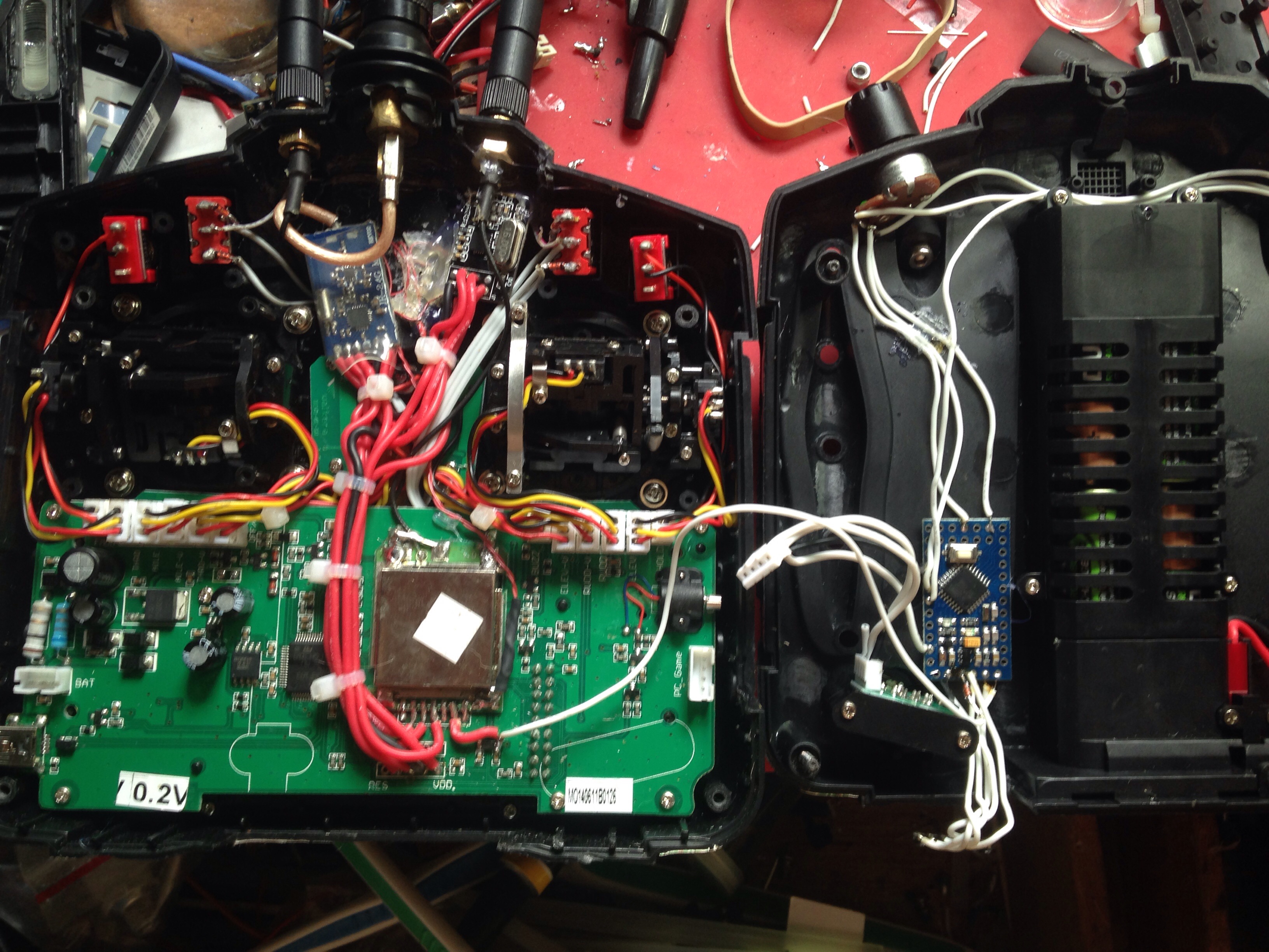

I dont remember off the top of my head but next time I open my TX I'll verify which wire, in the mean time you can put your TX into student mode so it's outputting PPM and then probe each conductor with a logic analyzer...
Edit: The PPM data input is the black wire for sure!

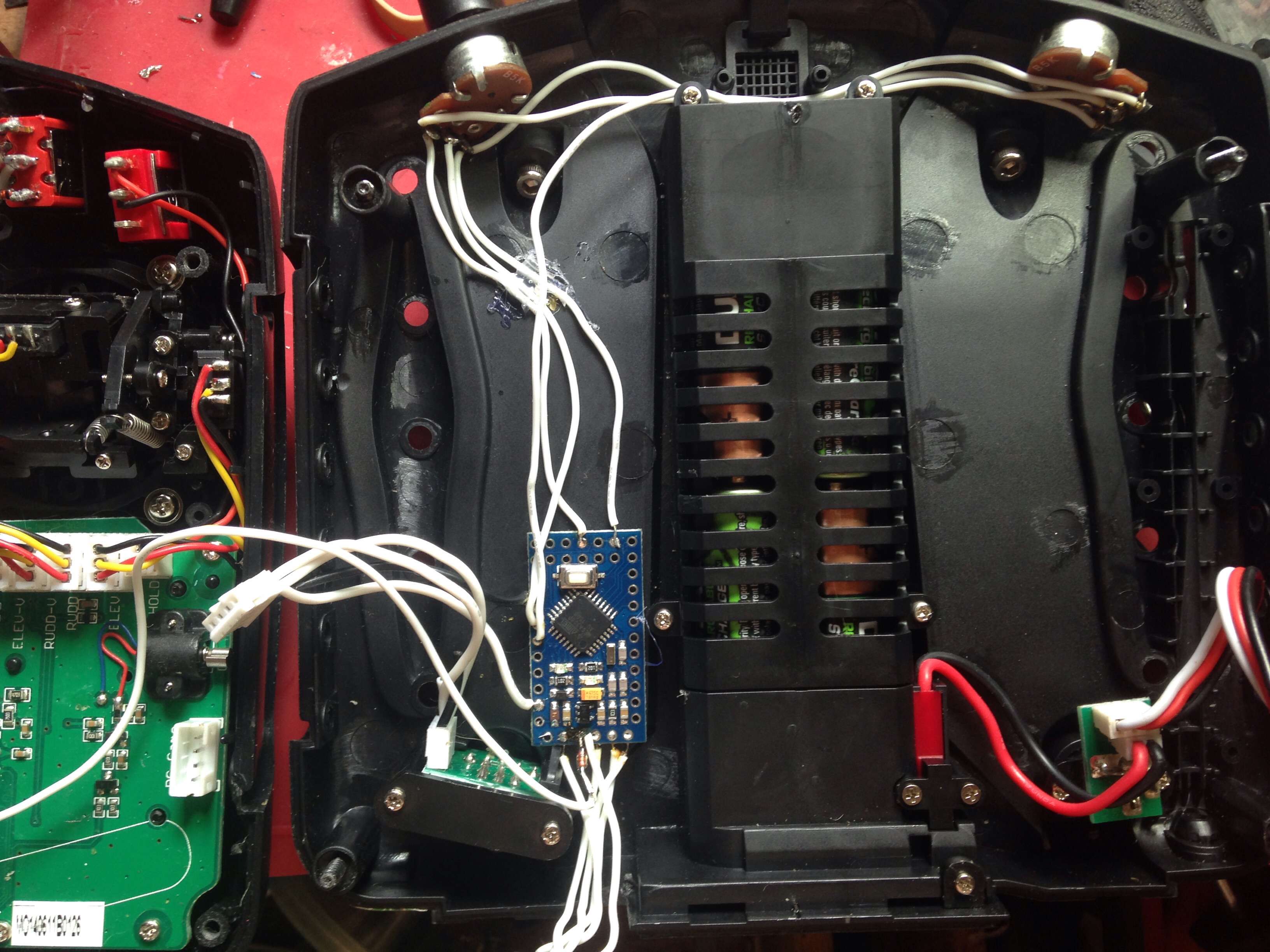

Worked on this more, till I either get a logic analyzer or can get someone with one to help I'm about as far as I can get.
I don't know about PPM enough to get it all the way working without being able to see what's going on. I have lots of bills and a family vacation this month so I can't just run out and buy one, does anyone happen to have one I can borrow (or does anyone want to take over)?
Edit: one correction to something I said in the video, I believe the pot's were like $11-12 shipped normally but I'm cheap so first I left their page up and then in a different tab navigated around HK's site (once you load enough new pages then go back it'll give you a buck off in a little pop-up, note you can do this with almost any product) and on top of that I had $3 worth of points. Even at full retail you're looking $15 max!

I just decided to mess with this code:
www.ianjohnston.com/index.php?option=com...d=3:hobbies&Itemid=8
Arduino nano
GND/A6/5v to a 100 ohm potentiometer (since i had that on hand)
D10/GND to trainer port
Set up as PPM -> Extend
Set channel 5 to PPM 1
Works. Working Pot on my Devo 7e. In fact, I could now add up to 6 channels more, i.e. extra switches or more pots.
Arduino nano

Ok I've got it running about as well as the old code, well actually it's more accurate and is giving my full range of the first pot however once again I cant get the second channel working.
I switched it to output on D13 (so I didnt have to open my case back up) and changed the AIL pot (channel 1) to A0, that all works, but when I tell it to look on A1 for channel 2 (actually no matter what I tell it) nothing happens. I've tried PPM2-6 as the source and nothing. This is what I really need the logic for...
Code as I'm running it
{updated 20150726 17:13}
Replied by Cereal_Killer on topic WORKING CODE!

Got it working!
After you set PPM IN to extend you have to click on it and set the number of channels.
Mine's working right, you can copy/ paste the code I posted a few up, it's setup for PPM out on D13 and the POT's on A1 and A2, they come in as Ch's PPM1 and 2, you can add up to 4 more POT's for 6 channels if you want. You MUST run it at 5V / 16mhz (or change the divider).
Woohoo, thanks for finding that (I'm guessing the first code worked too, I didn't know about the PPM channel setting)!

- Cereal_Killer
26 Jul 2015 22:17 #36091
by Cereal_Killer
Replied by Cereal_Killer on topic Extra inputs for Devo Tx's
You can pull GND and PPM in from the 4-pin connector but not power
Pull 5V from about anywhere you find it, you can see where I got it below.

- Cereal_Killer
26 Jul 2015 23:18 #36097
by Cereal_Killer
The Nano V3 has an on board TTL converter so you wont need the programmer if you use it. I use the smaller (and ~$1 cheaper) pro mini, same MCU but no on board TTL. Turns out I used pot's from a 9X, not a taranis.
Pot's $4.50 shipped
www.hobbyking.com/hobbyking/store/__3951...ansmitter_3set_.html
Arduino pro mini $2.25 shipped
www.ebay.com/itm/Enhancement-Pro-Mini-3-...&hash=item33766cb5d8
(If you go with this one 9url=http://www.ebay.com/itm/Replace-FT232-6Pin-USB-2-0-to-TTL-UART-Module-Serial-Converter-CP2102-STC-/321546809495?pt=LH_DefaultDomain_0&hash=item4addaef097]you DO NEED the TTL converter[/url]
Each POT get's 5V and GND, the center pin's of them go to A1 and A2 (A0, A3, A4 and A5 can also be used for additional input's, the code posted above is setup so that you must start at A1...) D13 goes to the input (the black wire). Pull 5V and GND from anywhere convenient, that's it. Really couldnt be more simple!
Pot's $4.50 shipped
