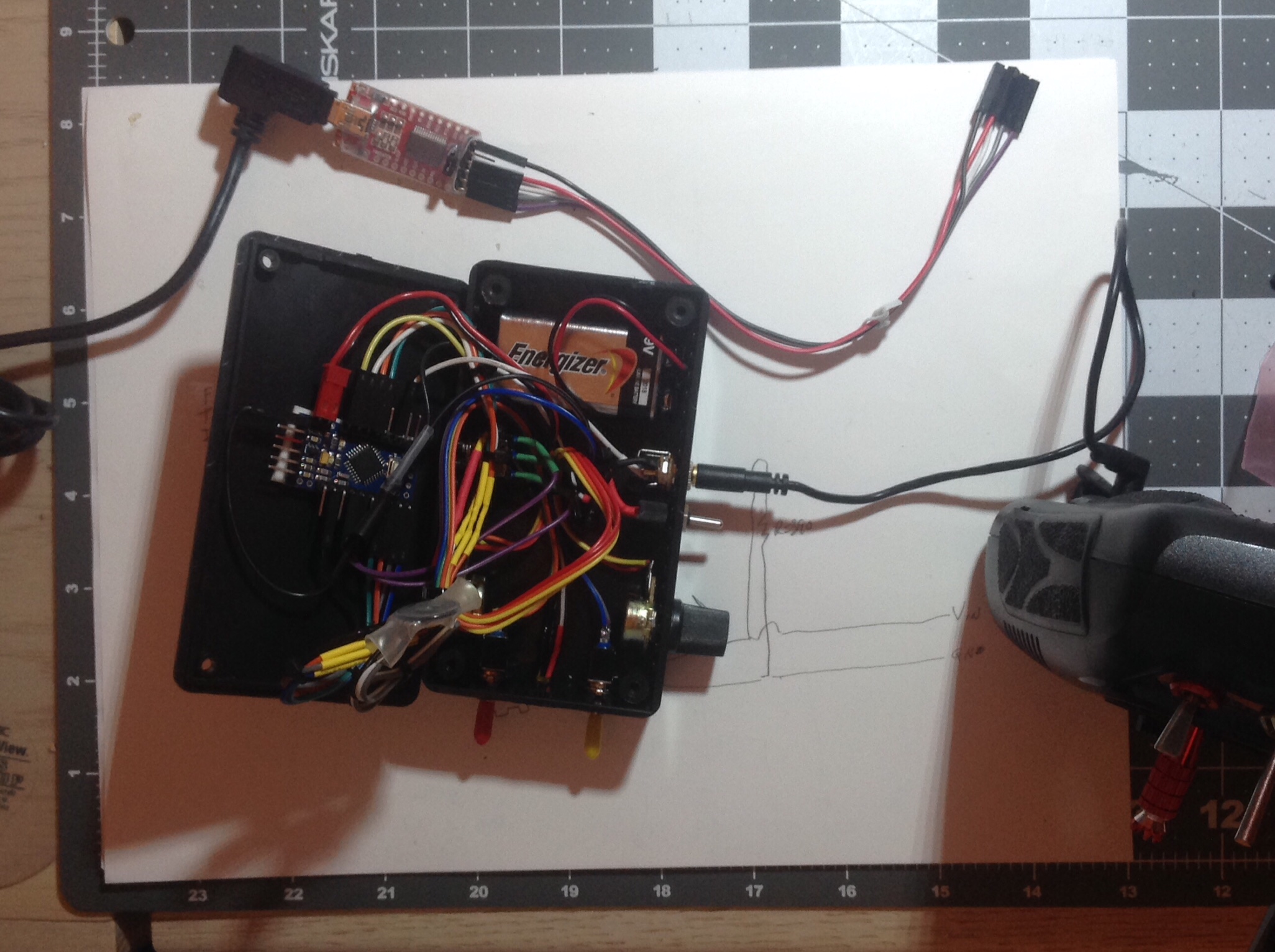

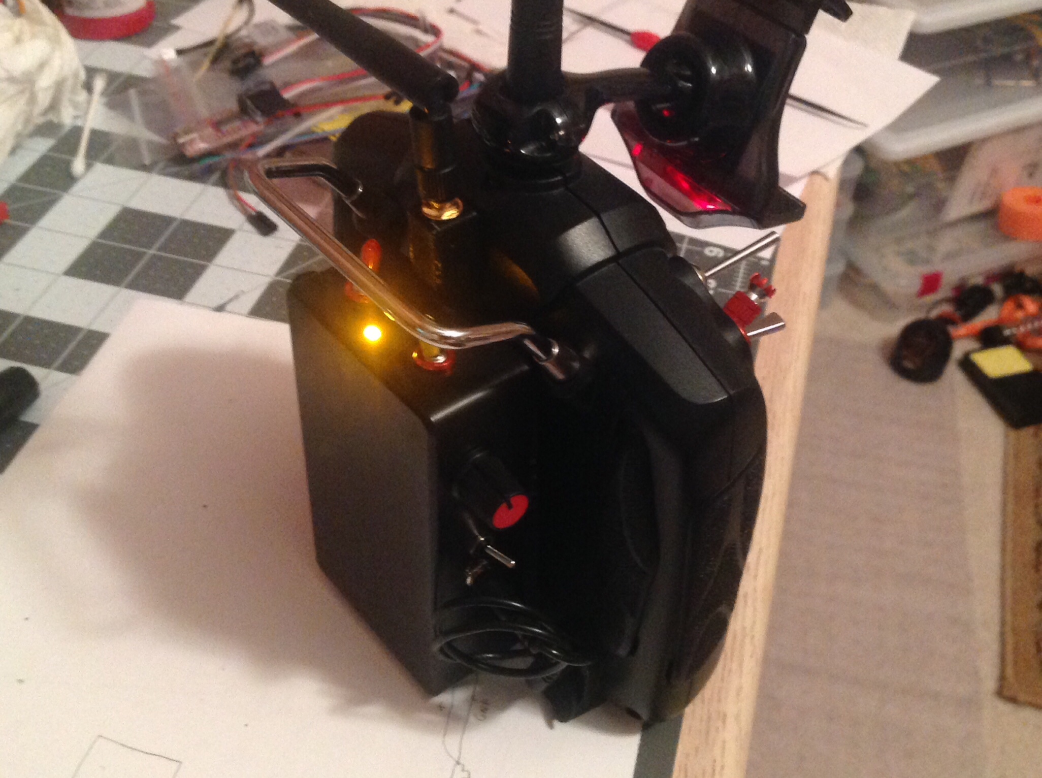

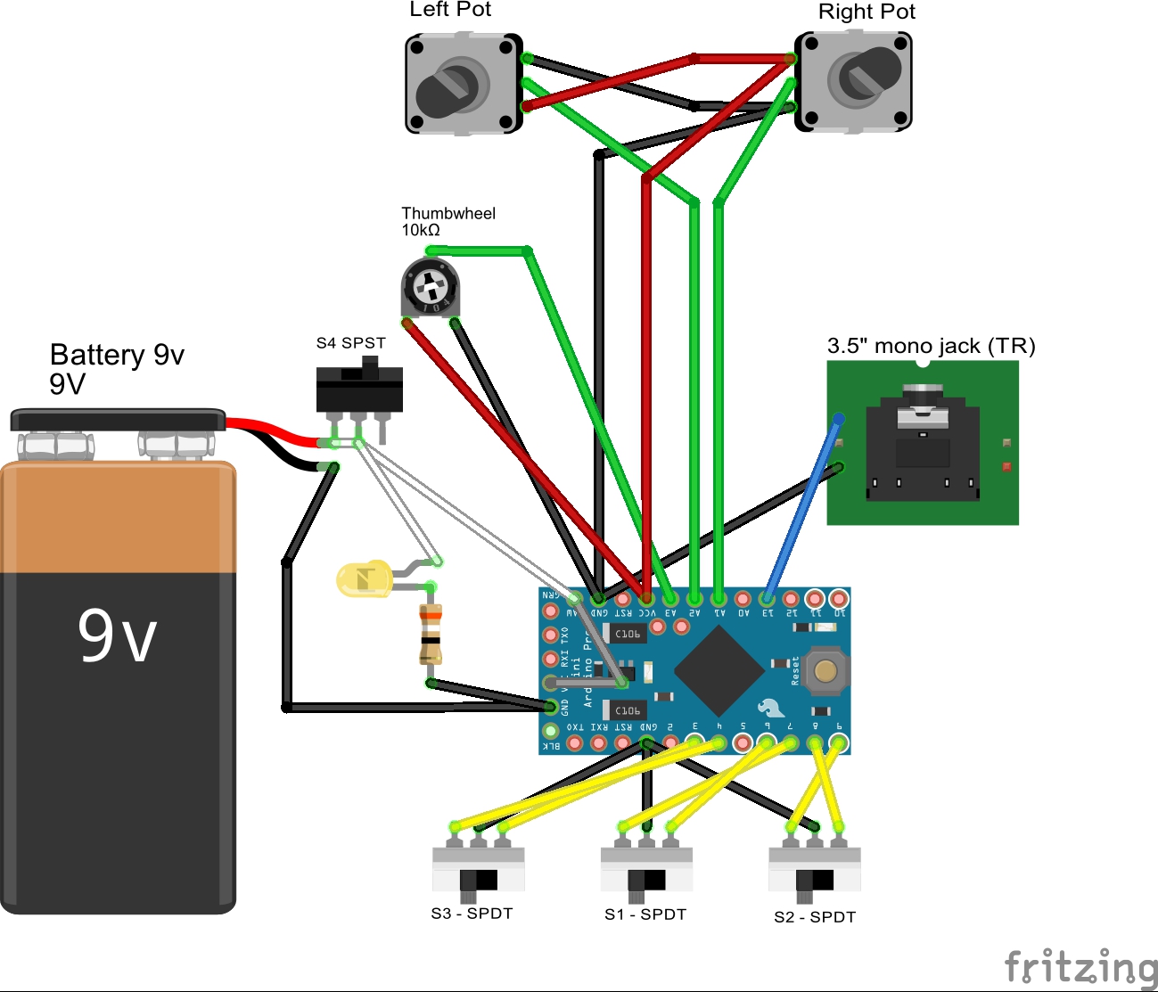

Instead of an internal solution, I opted to put my extra switches into a box that attaches to the back of the Devo7e. My box provides 2 potentiometers and three 3-way switches through the magic of the Arduino Pro Mini. The box is powered by a single switched 9V battery (with indicator LED) and connects to the Devo7e DSC port.
The advantage to this approach is that this box can be used with ANY TX that has a DSC in jack. However my main motivation is the ability to easily open up the box and add or change the functionality. My first modification will be to remove an existing thumbwheel (Analog port 3) and use a 6-position rotary switch instead.
This box includes:
Arduino Pro Mini ATMega328P 5v/16Mhz (eBay) - note I used the one without the USB port because I already have an FTDI USB-to-serial board
1 x Hammond 1591BSBK project box (112mm x 62mm x 27mm) (Amazon)
2 x 5k Linear Potentiometer (eBay)
3 x On-off-on switch (Radio Shack 275-325)
1 x 3.5mm 2-conductor phono jack (274-248)
1 x micro On-off switch (275-524
1 x 3mm yellow LED
1 x 390ohm 1/4watt resistor
1 x 9v battery connector
1 x 3.5mm 150mm phono cable
industrial strength velcro
The hookups can be soldered pretty quickly. I used a 90 degree pin and AMP connectors since I like to tinker. While it takes up more space, I can easily move switches or attach my programmer to the board.

The Thingiverse details are at www.thingiverse.com/make:154699 . I had the piece 3D printed commercially, so it cost about $15. The fit of the antenna RPSMA mount is very tight. I had to carefully file away where needed so I could get the mount up the sleeve into the hole. The mount was an IPX-U.FL to RPSMA pigtail from my favorite cable supplier: www.ebay.com/itm/2-Mini-PCI-IPX-U-FL-to-...0555?var=&hash=item0
Using the U.fl connector allows me to disconnect from the module when I take the Devo 7e back off.
It fits tightly into the square in the back of the Devo7e and I used a bit of CA on the corners to keep it in place.
