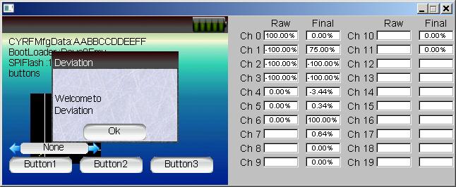

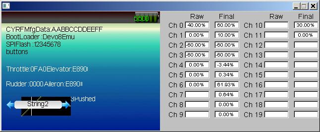

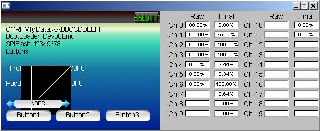

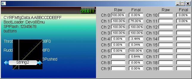

18 May 2012 20:25 #325 by FDR
Replied by FDR on topic Re: GUI
Thank you!
I followed your instructions, and now I have something, but I don't know is it right:
Is that what is should be like?
There were quite a few "unused" warnings in the fltk and some in the deviation too...
18 May 2012 20:30 #326 by PhracturedBlue
Replied by PhracturedBlue on topic Re: GUI
It looks fine, but I'd like to see your compile messages fro deviation. I don't think I get many warnings. For the fltk build you should be able to ignore the warnings.
Use '3' and '4' to switch to different pages. The default page is just a test-screen for various widgets. I believe that '1' will enter screen calibration mode, and q/a, w/s, e/d, and r/f should control the throttle, rudder, elevator and aileron. '1' will enable screen calibration (not very interesting for the emulator)
