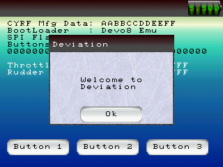

Cool, also enough issue is static font color... we need a string printing function that can be passed a color code. I got frames working today, kind of a generic image object, though I am going to put some sort of 'parent-child' tie to it and gui objects that will be contained in them, this way on redraw everything can be rendered properly.
My next step is a dialog box, as well as a method to 'disable' a gui object from interaction, so that when a dialog is up nothing else responds.

How big of an impact does a pointer have on memory? I am working on getting Dialog boxes in, and I am almost done, but I tried to assign a callback function that has a different parameter setup then what the guiObject is spec'ed for, and obviously it doesn't work
. So I need to add a callback pointer to the Dialogbox struct, which means any other object needing a custom type of callback is going to need an extra pointer in the struct.
