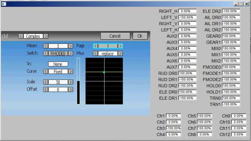

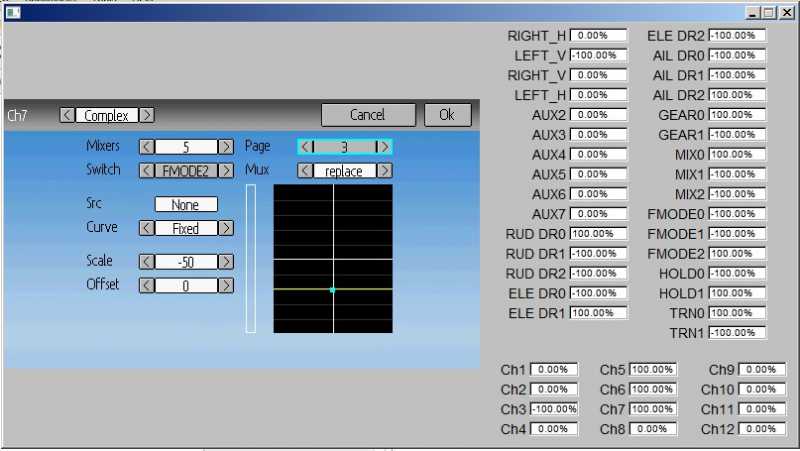

Does anyone has an idea how to do this for 6 modes on the Deviation software? (I know how to do for 3 modes)

You can use complex mixer with 4 pages. First 3 pages ('replace' mux) with 3-position switch (SWX_0, SWX_1, SWX_2) and 3 fixed values (1165, 1425, and 1685), last (4th) page ('add' mux) with 2-position switch (SWY_1) that can add small fixed positive value (add 130) for each replace mux (1295, 1555, and 1815).

I think I got it. But I think it has to be 5 pages. If use 4 pages, it doesn't go down enough. The 5th page will add minus value to minus value, so reach to minus 100%.
Thanks, I now understand the system.

You can use 'Offset' at 4th page to add additional throw.

I have refined the way the switches are allocated and came up with this solution (applicable for the Devo12S):
The FMOD switch defines 3 stages: MAN-STAB-AUTO
The RUDD D/R switch defines 3 stages: CIRC-FMOD-RETL
The RUDD D/R switch is kind of a "panic" button and either lets the FMOD switch define the mode or overrides whatever mode has been selected to either circle or return to launch.
The programming is very simple:
Choose whatever channel you have dedicated to your fly mode and choose "Complex", 6 mixers
Page 1: Switch - FMODE0, Curve - Fixed, Scale - 70, MUX - Replace
Page 2: Switch - FMODE1, Curve - Fixed, Scale - 45, MUX - Replace
Page 3: Switch - FMODE2, Curve - Fixed, Scale - 10, MUX - Replace
Page 4: Switch - RUD DR1, Curve - Fixed, Scale - 0, MUX - add
Page 5: Switch - RUD DR2, Curve - Fixed, Scale - -73 (Minus 73), MUX - Replace
Page 6: Switch - RUD DR0, Curve - Fixed, Scale - -47 (MInus 47), MUX - Replace
This will give you 5 flight modes where the RUDD D/R switch overrides the FMOD switch in position 0 and 2. Position 1 leaves the modes to the FMOD switch.
