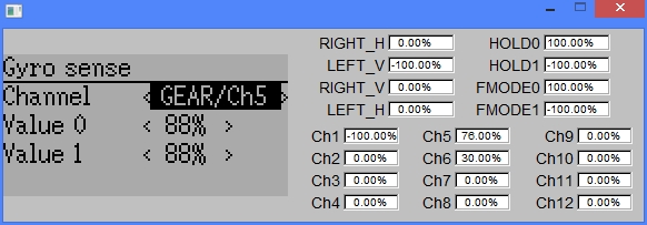

Output channel is -100 to 100 raw value.
88*2-100 = 76
88*2-100 = 76
Tom Z wrote: Thanks. One more question.
Gyro - I put in 88% and on the gyro output channel it reads 76%.
This is on the right hand side Ch5. Does this mean the deviation firmware converted the 88% to 76% or does 76% mean something else?
