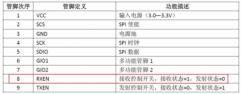

Did you wire "RXEN"(PIN8) to GND?
If not , please try it!

It seems like this fixed the problem. But as this was just occasionally I need to do some more testing to be sure.
Whats the meaning of RXEN and GND and all the others? Is there an explanation anywhere? I also connected PIN9 with PIN1. Is that right?

i have already edited tx.int. but i did not connect pin 9 to pin 1....
i also do not understand how to connect pin 8 to GND? where is GND?

already binded.... i connected pin 8 to pin 3. now it all fixed! thanks
