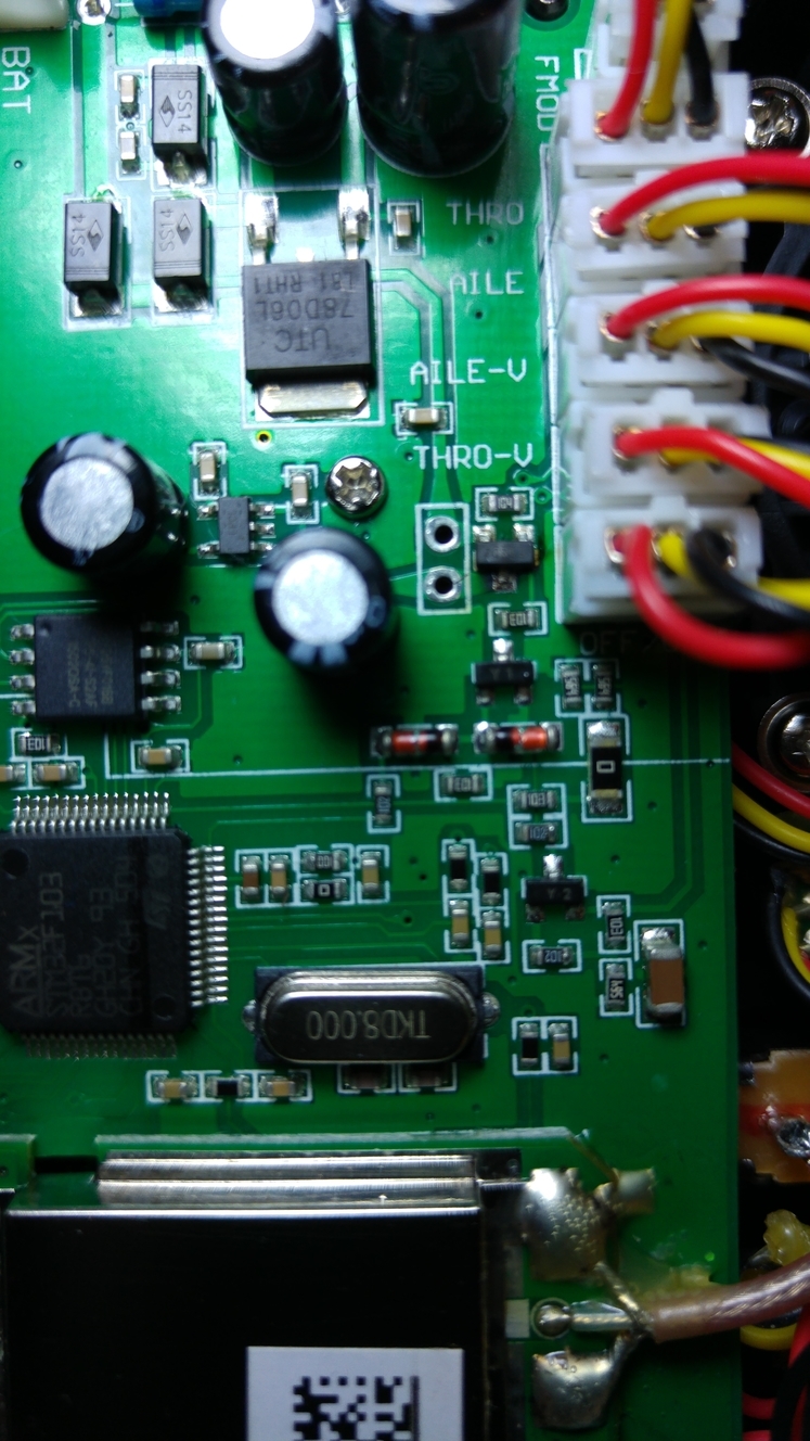

Can you post a close up photo? This sounds like a weak short,and it's pretty small stuff to work with, so it may be obvious.

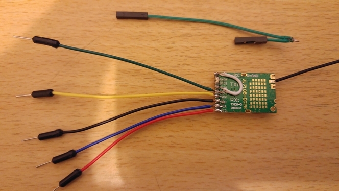

There's not much to see really as I've removed my mod after the power on trouble started. I've visually inspected my solder points and used my multi meter buzzer to check what could be bridging.

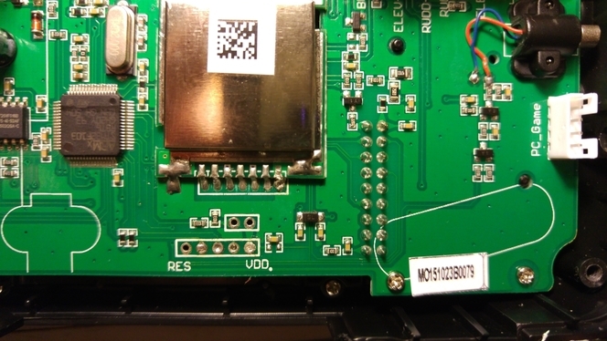

The second picture shows what I was trying to do. I was going to add 4 dual dupont wires for the main connectors and 2 single wires for TMS and TCK. Each module was going to share the dual wires and have either the TMS or TCK. I was going to add the A7105 today and the NRF24L01 later. I didn't get as far as editing the config file to say what modules were installed where.
The third picture show one component I'm unsure about. The small black 3 legged part (don't know it's type) just below where it says THRO-V next to the 2 holes. I'm not sure if that looks healthy? I have seen that burnt out in another picture on this forum. Would it's part type be relevant? Could I have killed it with a power spike?

Going off your description my first guess is you've burnt a transistor who's job it is to turn off the P-FET that switches power on/off. Unlike an N-FET, a P-FET can't turn it's self off, it must be pulled down with a transistor (typically a NPN type BJT) to shut down. Based off your description of how the screen hangs on after power down I believe this to be your issue.
Do you have an LCR meter? Are you capable of SMD soldering? If not you may want to consider paying someone here (John M Barter who does devo mods here and on RCG or someone like that), I'm capable and enjoy working on stuff like that but I just do not have the time to offer you my services... good luck.

Is the firmware version important when related to what points you bridge?
I was using stock 4.0.1 when I installed my module (i didn't realize it was so old and nightly would be better) and wired the module as above following instructions from.
www.rcgroups.com/forums/showthread.php?t=2570426
Second picture.
I wonder if that caused my power problem. The reason is I've found this image of wiring the same module.
www.rcgroups.com/forums/showthread.php?t...page=56#post27524160
Again second image. The pins that are connected are very different. Is one setup for the old firmware and one for the new? I really don't want to burn out another transmitter.

Yes, the witing changed after 4.0.1. Please follow the links entry in the left-hand menu, and then the module installation guide about halfway down that to the official instructions, which are maintained and updated as things change, unlike blog entries, YouTube videos and forum posts.
