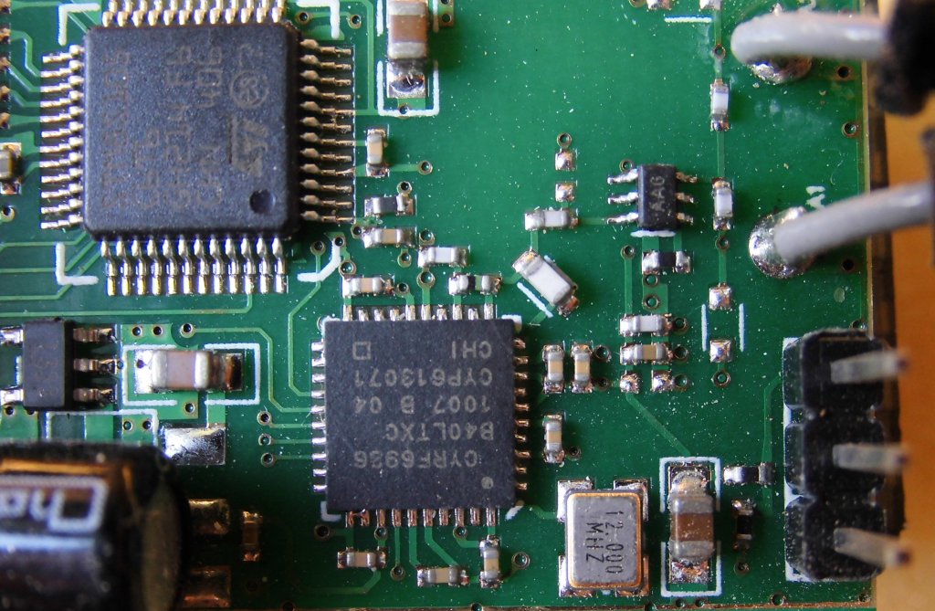

- aMax
- Posts: 776
01 Apr 2016 12:46 - 01 Apr 2016 12:49 #45560
by aMax
Replied by aMax on topic Devo 7e 100uf 2m with dsmx & 20m with Devo rx
Well, if Devo works for you,the module is not fried. You better check the rx, since I am able to get the same range with a S603 as you posted for the RX1002. The weakness is the antenna part. Signal aplification by a simple RF transistor (AAG) and no diversity..
If the antennas are well oriented, it outperforms the RX615X (no LNA but diversity),.....but unfortunately not at flying a quad etc."
Edit: check this part of the rx (photo...
Last edit: 01 Apr 2016 12:49 by aMax.

- lahiru4216
- Posts: 46
01 Apr 2016 15:30 - 01 Apr 2016 15:37 #45575
by lahiru4216
<<<<<<<<Fly Harder For More Fun>>>>>>>
Replied by lahiru4216 on topic Devo 7e 100uf 2m with dsmx & 20m with Devo rx
Last edit: 01 Apr 2016 15:37 by lahiru4216.
