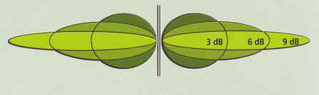

From my understanding, a "typical" omnidirectional 2db or 6db 2.4gHZ antenna has a radiation pattern that looks like a "donut" (without the "hole"), with a "null" spot directly in the direction that the antenna tip points to.
Give this, and given the fact that most (non-FPV) people will face their aircraft with the transmitter "backside" in the direction of the aircraft, wouldn't it make more sense to turn the antenna SIDEWAYS instead of sticking it up vertically like most people do?
That way, as the aircraft climbs, it will not leave the "donut" as fast, since the donut will be vertical instead of flat horizontal. The radiation "null" area would be pointing "sideways", instead of up in the air where the aircraft will eventially fly into it as it climbs.
Does this make sense? Is my thinking correct in light of wanting maximum range for quads? Am I overthinking this, or would turning the antenna sideways maybe give real improvement for high flights?

As far as I understand it the 7E and 6 have a monopole, so no real "donut", but inversely less concentration so less planar range. The more dbi the more pronounced the donut and thinner the plane of radiation (this is all regurgitation BTW, I'm only going on minimal info I've read elsewhere)

Just envision that a "rubber ducky" antenna with a higher gain design, say a 6dB or 9dB, will not be circular shaped like a 3dB is, being squashed flatter, like a flattened donut, giving more distance but also being more directional, so aiming it at the model is more critical.
