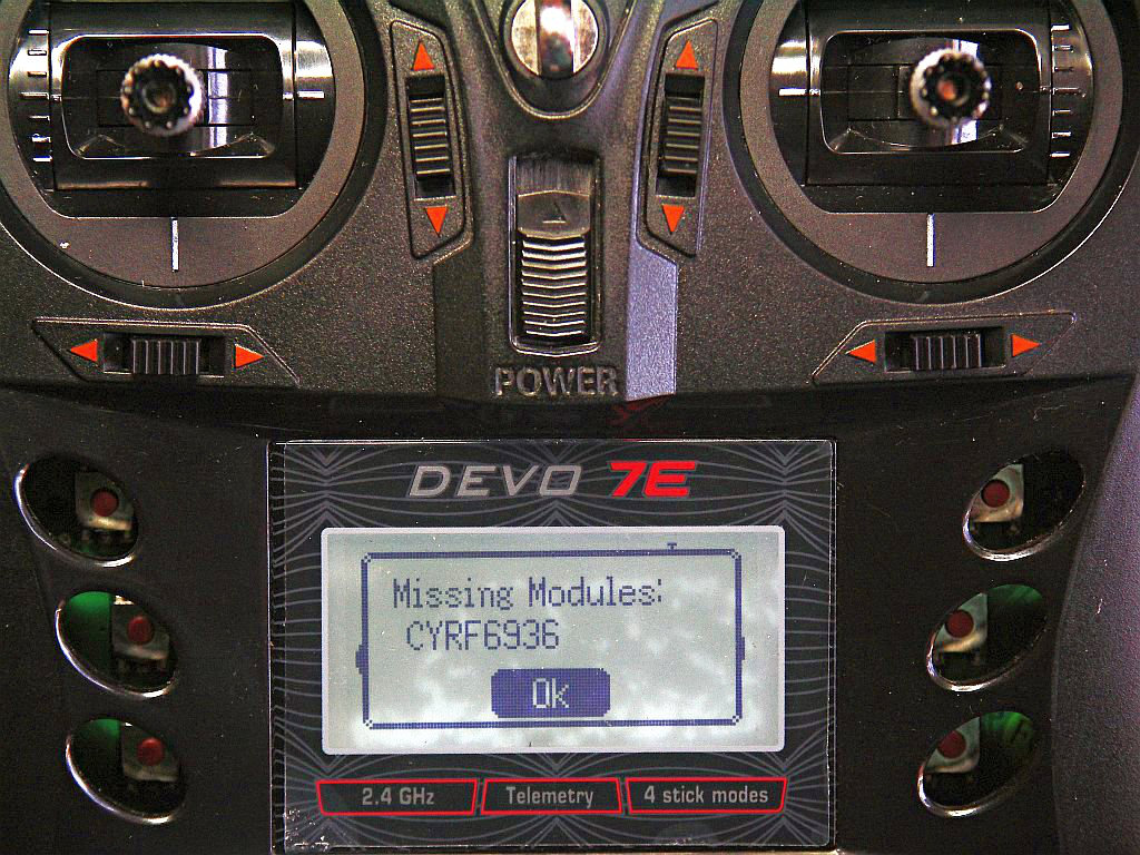

- bianchifan
- Posts: 49
09 Aug 2016 10:07 #52609
by bianchifan
I didn't knew that fact although I#m wondering about this behaviour.
Nevertheless I organized yesterday all that google stuff, every possible BL and all the other tools mentioned around.
1st.. the 256k-BL did installed fine without any problems with my cheap 2$-Ali-Link.
2nd.. All drivers installed without errors (V 1.1), but the JAVA-Service-tool doesn't recon the devo (V 0.8.0)
Maybe driver mismatch, I installed both, deviation plus Walkera, uninstalling, reinstalling, nothing helps.
So only Dfuse works for me.
3rd.. The firmware sucks.. it cries for the Walkera module I liked to strip and throw away.
What can I do?
Replied by bianchifan on topic MCU swapped. And now? BL? Where to find?
Ok , I got it.mwm wrote: Rather than replace the bootloader, the deviationTx firmware downloads are encoded in that tweaked format, which obscure the code
What can I do?
