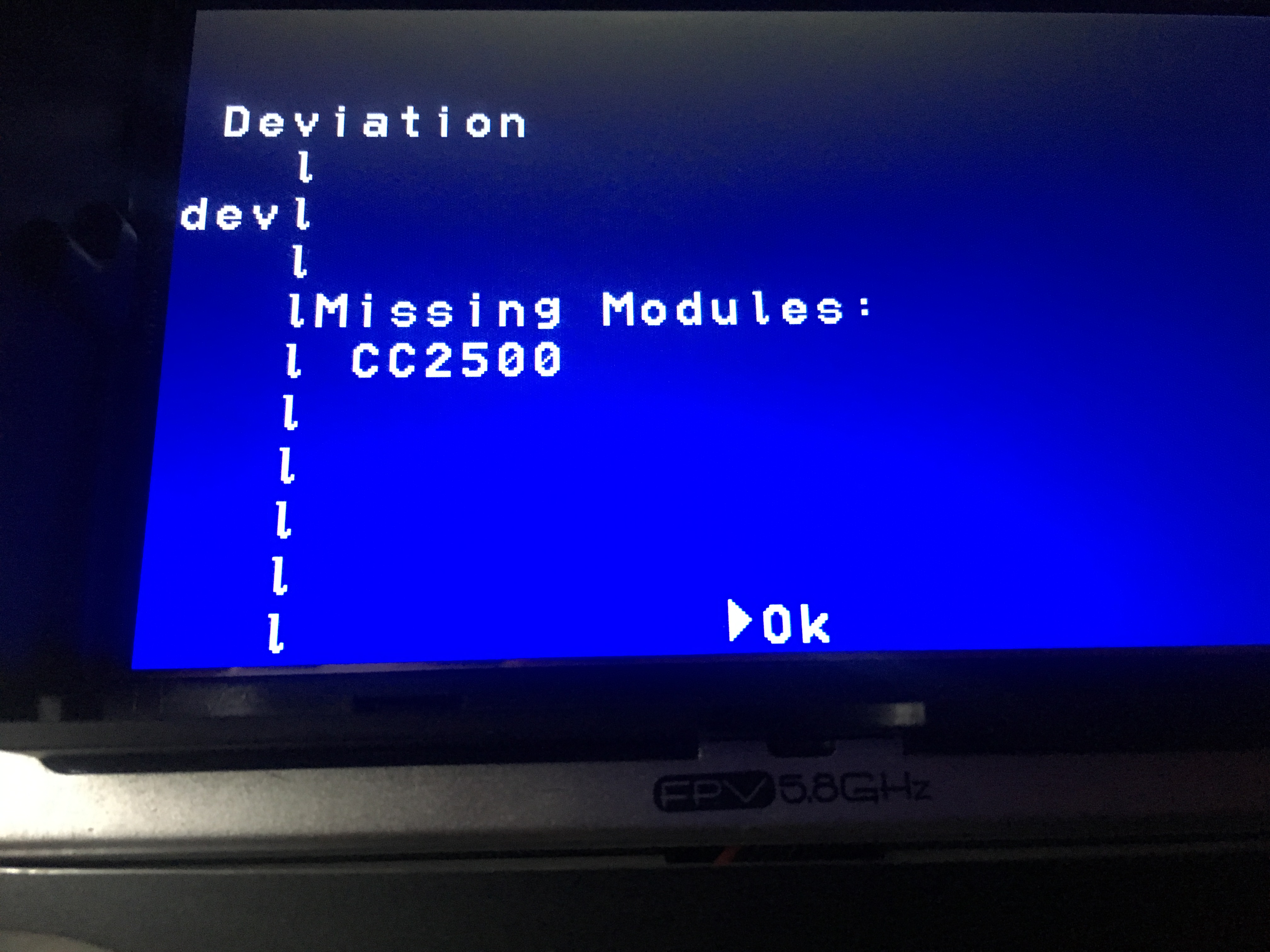

I'm using Deviation since 1 year on my Devo 10 - working great! NRF and A7105 installed. Meanwhile i have a F12E - but i dont use this.
Since some days a have a second F12E - so i started to try deviation 5.0. i am reading sometimes the instruction and the first installation was ok. My F12E is starting with Deviation - but i was not able to store models - or other changes. (Nightly 23.12)
I flashed back to Walkera firmware and tryied a second time. The same result - no model available and no storing. I am reading here in another thread - to copy via usb the unzipped "devo.fs" - this one on my transmitter was empty.
Yes- it works
Deviation Uploader shows no files in FileManager.
Now i have 2 questions -
how to bring a changed TX file to my F12E - cause i want to install a cc2500 modul.
(Same question for model-files)
output power - i have 2 F12E - one with 10mW (German Version) and one with 100mW
Is Deviation able to increase this output of 10mW ?
Thanks a lot for your help
-Richard-

So - after reading the long f12E thread i can answer the TX power question by myself -
Deviation unlocks the power restiction
I have tried several times to install Deviation on my F12E, the devo.fs is always empty. for me its only possible to transfer this file via USB to the transmitter.
And I have no access to the files on my F12E with the deviation-uploader. I am using the nightly 23.12.
Is there another nightly to use ?

I have tested your dfu file
It was not possible to send this with deviation-uploader - "send" button stays gray
So i changed to Walkera dfu - and upload your file. Started the TX again - and it works
Next step i exchange the fs file - but this does not work for my TX, i try that one from the nightly - and this works
I compare the contend of this 2 fs files and they are different.
And sorry - i really dont know hat 5.0 is not working for F12E - i have seen some posts that its possible - so i tried this also.
It would be nice to have in future a possibility to activate an additional TX modul.
Thanks you for your help - and i hope we will have a next success

.. some hours later i have successfully installed Deviation on my F12E and bound with a FrSky X4RSB Transiever.
I am very very happy now
The most work is to find all the informations you need for such a projekt.
Thanks a lot for such a great community which has invested plenty of time to build up
I have a JJPRO P130 completely disassembled - flashed the ESCs with Blheli - replaces the FC with a NAZA32 FULL Rev6, adding minimOSD - tested several GPS . I want to have a full featured small Quadcopter.
Next will be a 150 mm full featured Quadcopter with CC3D Revo FC.
(Hope both will fly one day
