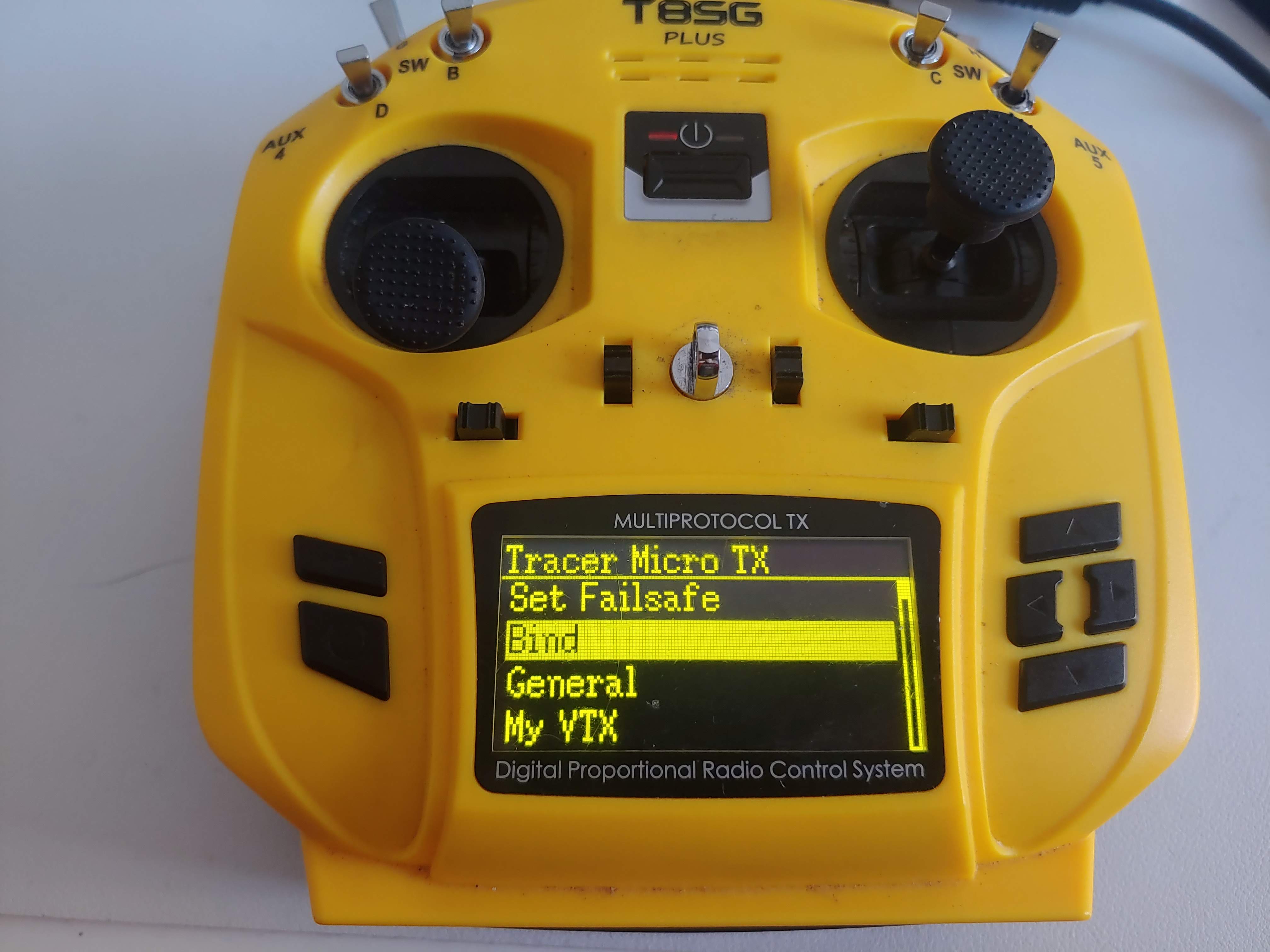

I have TBS Tracer and T8SGv2 plus. I've performed the hardware pin mod to enable crossfire and was pleased to see that the TX module, Wifi module and Nano RX are all visible in the CRSF menu in Deviation.

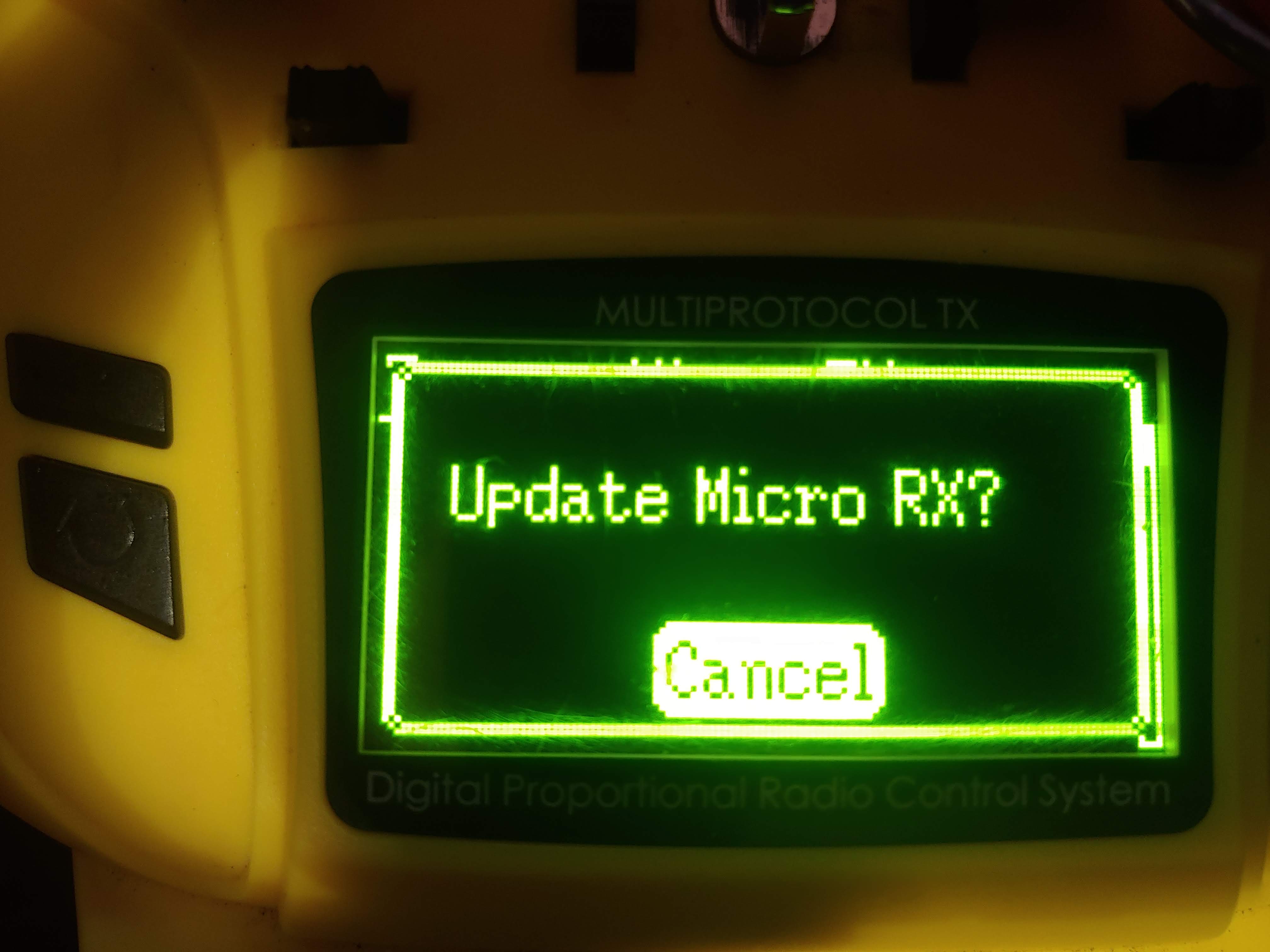

However, there are some peculiarities. For instance the prompt to update RX firmware shows only a "cancel" option, I think I tried this 20+ times and eventually I got a "ok proceed" option but I cannot replicate this on the other RX which needs updating.
