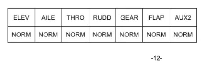

The channel sequence of the Devo is EATR for the first four channels, which means Elev,Aile,Thro, Rudd.
According to the table on page 12 of the operating instructions, the next three channels are Gear, Flap, Aux2. Gear is channel 5, so Flap should be channel 6 and Aux2 channel 7.
I would continue the search, link channels 5 - 7 to the desired switches accordingly and simply try it out.
I also searched a little with Goggle and also didn't find a config file or a description.
