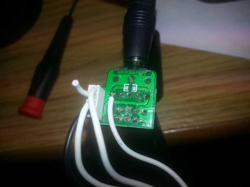

Here is a pic of the mod to get full RX/TX USART working on the trainer port, what I did was cut the RX line and solder it to one of the unused pins of the 3.5mm jack. This gives unobstructed RX/TX lines to the port.
I doubt the STM32 is 5v tollerant so I am waiting on some 74HC4050 buffers so I can use them as TTL level converters before I go hooking up any external MCU to do a full serial test.
Replied by MatCat on topic MatCat's Devo 8 Expander

Actually after doing some research it appears the STM32 is 5v tollerant on the USART, hooray!

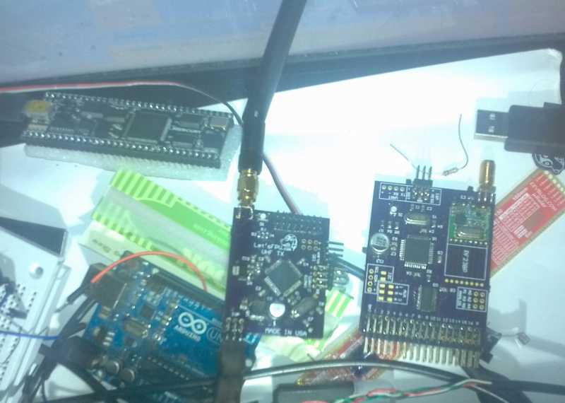

Just wanted to let whomever is watching know that I am finally ready to tackle some code for this project.
I plan to start off with by adding a new Protocol called Serial. This will turn the 3.5mm jack into a full UART1 Serial port. To get full bi-directional capability the hardware mod will have to be done as specified above, otherwise it will still function to output data.
The first goal is to get the channel data out, which my UHF TX will read and formulate into a proper packet for the RFM23BP.
The second goal is to get full bidirectional communication so that I can use external inputs and pull them into the Devo mixer as new channels.
The third goal is to implement a custom interface for configuring the UHF links, both TX and RX, and any other hardware peripheral support I want.
The fourth goal is to get telemetry input working on this link too (since my UHF system is fully capable of bidirectional communication, why not?)
Here is a quick sneak peak of the UHF RX/TX (RX is the bigger one wit no antenna
