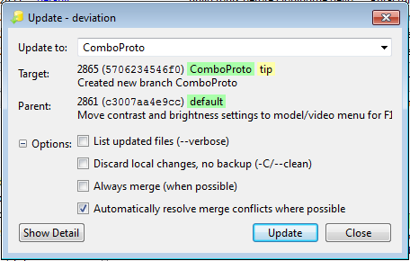

I'd like to do this also. So I am guessing this would be my next step. I've gone to bitbucket and added a branch to my deviation repo. On my local dev machine, I had to "Check for incoming changes" for it to pick up the new branch that I had created. Then I updated the working directory to the new branch that I had created...
Will each pull command generate an equivalent branch in my repo? Then is there a specific command to merge that branch into another branch? I'm getting myself mixed up between the website and the local machine.

That's the right next step. You could have also created the ComboProto branch on your local machine and then push it to bitbucket. Or also merge everything to that branch on your local machine and make builds without ever updating bitbucket. Or do all that and then push all the changes to bitbucket at once. Some things you can't do on the web page - I haven't found a way to pull a branch from another repo on bitbucket.
Yes, pulling a branch will bring in all the changesets in that branch up to the closest common parent. I'm not sure how the Windows client works. On Linux pulling the branch does not automatically update to that branch, so if the working directory is the ComboProto branch then after the pull comes. A commit must follow a merge before any other repo updates can be made.
hg merge -r <branch name>
hg commit -m "Merged <branch name>"- mwm
