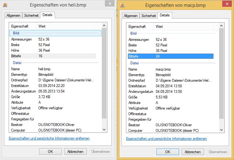

But I still have a problem with it.
I can't see it on the Devo 7e.
I copy the file in the same direcetion like the original bmp's.
Then i restart FX.
Then i choose the Icon in the Model Setup.
There are the original bmp's with name and picture and yours but only the name. No picture. Also if i choose it in the Main page is no picture too.
What is wrong? I compared the properties of your's and the originals (see Screenshot).
The only difference i see is bit depth (original = 16, mastercp = 24).
Maybe this is the problem?
Sorry I'm not good with this and sorry for my bad english.
Thank you so far.
Thank you so far.
greetings

That's the reason. Sorry for that - must have attached the wrong file. Give me one sec and I'll copy one from my Devo as it works OK there.
Replied by czajunia on topic Searching Icon MASTER CP for Devo 7e/10
revilo16 wrote: The only difference i see is bit depth (original = 16, mastercp = 24).

oh wow now i got the mistake.
it was my fault, sorry.
but this was not easy to find put for me.
normally i use Firefox. but in Firefox i didn't see the bmp's in this Forum.
It was only a brocken Picture to see.
so i used Internet Explorer.
And opend the the bmp's an choosed "save Picture as..."
Then they are always 24 bit, also the new one and also the others in the forum.
Don't ask me why i don't understand this.
But that was the reason why it didn't work.
Now i downloaded it in Firefox with "Save Link as.." and:
Same File clicked -> diffent bit depth. There it is!
Now it work.
Thank you so much. It looks great at my 7e.
greetings,
Oli
