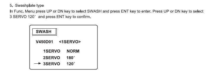

Why do you have the swash type as 120? Does the 2702 not do the ccpm mixing for you? I will be installing one on a trex clone soon but was not going to use a swash type. Just straight channels like any other fbl.

Yes, it doesn't do the ccpm mixing.
Replied by domcars0 on topic Searching for a V450D01 - WK2801 setting
Hexperience wrote: Why do you have the swash type as 120? Does the 2702 not do the ccpm mixing for you?
Not with the RX2702V ....Hexperience wrote: I will be installing one on a trex clone soon but was not going to use a swash type. Just straight channels like any other fbl.

The Genius and V120D02s are using "1 servo/Normal". As domcars0 confirmed the RX2702V-D on the V450D01 (V1) uses 120'.

For all users setting up the RX2702V the fist time I recommend to use the new version V3. Thumbs up to the team !!!
Please start with setting: Mixer GUI: STANDARD !!!
Then start with the swash setting 3x120
Then you can easily set all parameters as per your needs.

If you use STANDARD GUI it is very easy for V450D01.
Setting swash 3x120 and reduce all 3 values below to 40%. Then the heli is less agressive.
