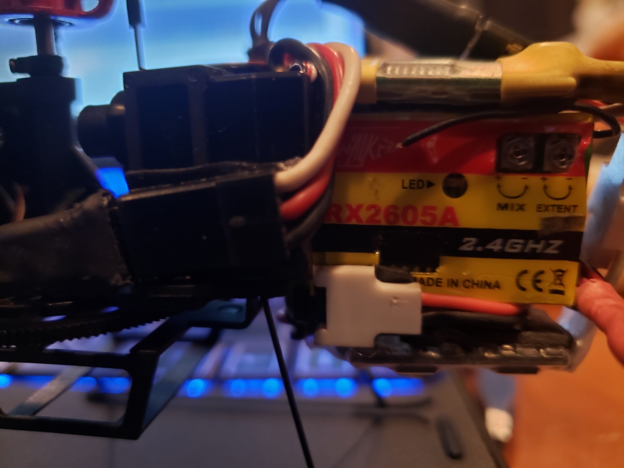

Yes but only with a RX2605A Receiver, not with a RX2605 (without "A").
Which Receiver do you have installed at your 4G3?

- Jay1978
- Posts: 8
- -=Hubi-Dirk=-

That is a pity. I have searched a lot for a solution to bind the RX2605 to the Devo, also in different forums, unfortunately so far without success.
The receiver binds in WK2601 mode, but the control does not work properly, it seems that channels are swapped.
A special feature of the RX2605 is, for example, that the pitch curves for normal and 3D are stored in the receiver and the transmitter only sends the selection of the Flightmode.
Maybe you have the luck to find a solution, then I would be very happy about a hint from you.

Well this sucks. Thanks for the reply. I am trying to find a rx2605a. I don't have the transmitter.
