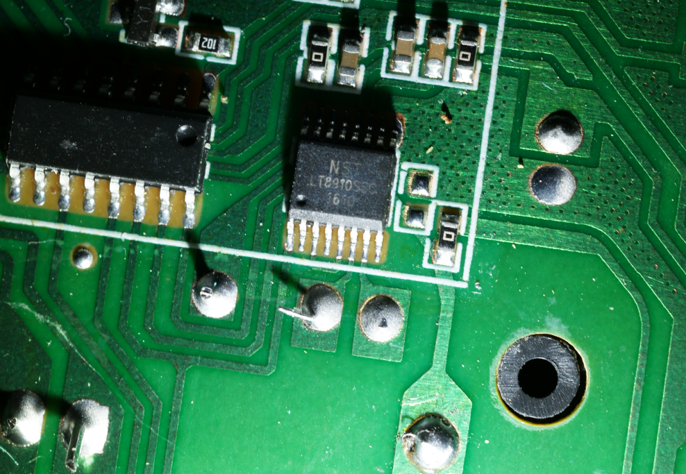

The JJRC H97 and the Goolrc X5C have the same remote control (KY-M7-H31T) with chip NST LT8910SSC 1610.
I will receive a logic analyzer in the next few days.
Can you help me to wiring the LT8910 with the logic analyzer. I did not understand everything by watching the video.
Last edit: 01 Oct 2017 17:25 by Elric. Reason: picture

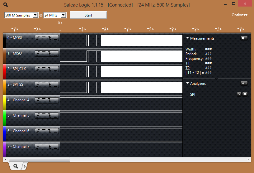

17 Oct 2017 20:32 #65094
by goebish
Replied by goebish on topic protocol for JJRC H31?
Same as witth Schamane's captures, that doesn't look like LT8910 data ... there are other data on the SPI bus, so I'm not sure SPI_SS is connected to the right place.
www.deviationtx.com/forum/protocol-devel...c-h31?start=20#62902

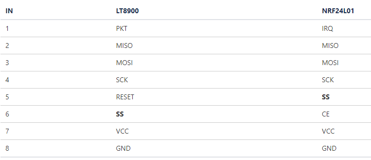

which head should have the SPI_SS? do you have an example?
- goebish
- NRF Weirdo
- Posts: 2633
17 Oct 2017 20:57 #65096
by goebish
No, but just make sure SPI_SS from the LT8910 is connected to the analyzer. If you're sure that's the case then I don't know. The LT8910 is not emulated by deviation anyway, except if the protocol uses it in a specific way.
- Elric
- Posts: 37
17 Oct 2017 21:18 #65097
by Elric
Replied by Elric on topic protocol for JJRC H31?
On LT8910, PIN 13 (SPI_SS and PIN 14 (PKT_flag) are connected together.
it is a problem ? or it's normal

- Elric
- Posts: 37
17 Oct 2017 22:47 - 17 Oct 2017 23:21 #65100
by Elric
Oooop ! fail
Last edit: 17 Oct 2017 23:21 by Elric.
