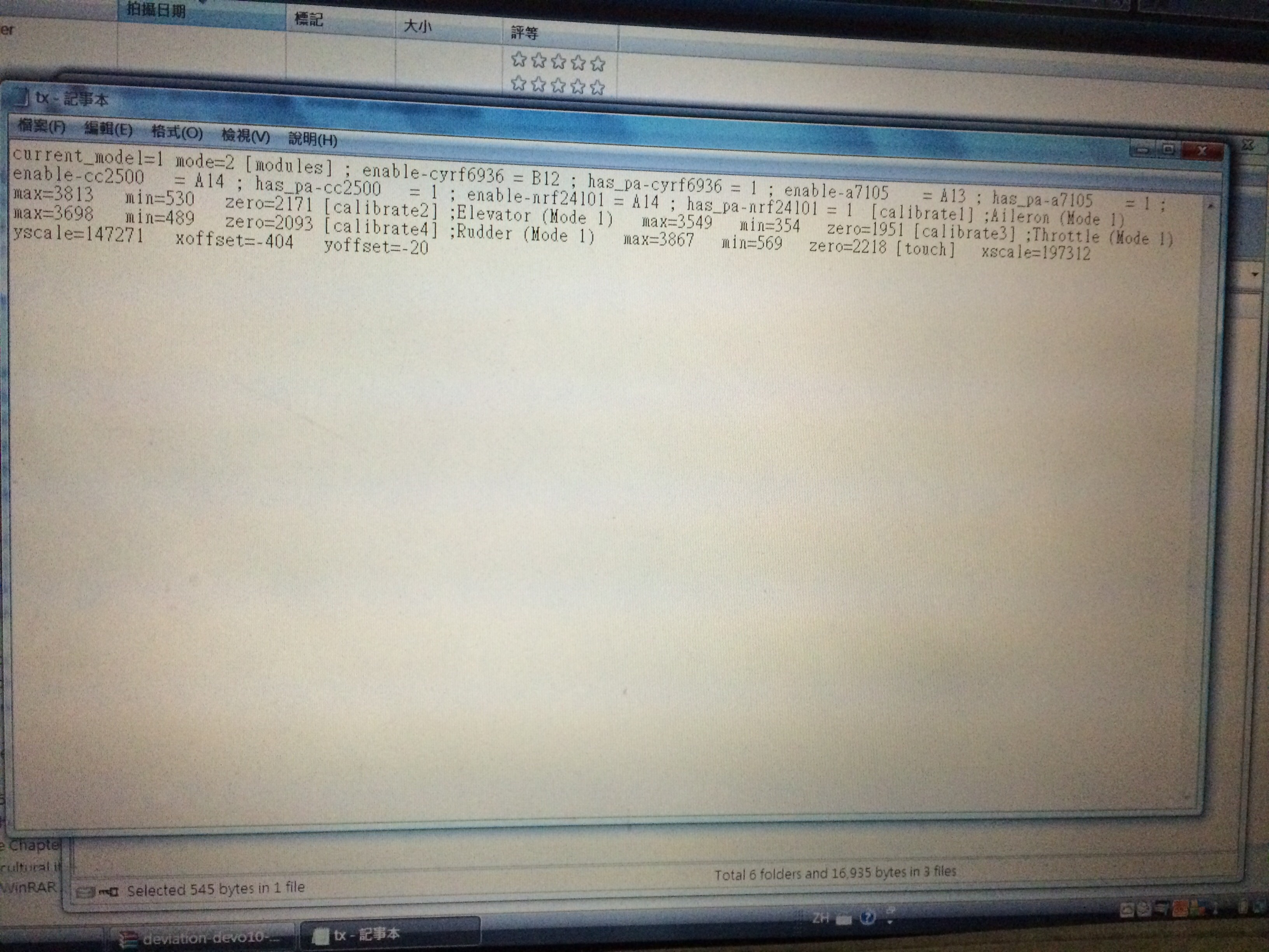

i use deviation 4.01 and build A7105 module, but i cannot bind a hubsan and flysky ,i uae a devo 10 white one, my control unit show on the model select only hubsan and flysky before the letter have * ,anybody can tell me how to solve the problem,

If you've got a '*' in front of the protocol name, then the Tx isn't seeing the A7105 module. Either it's not connected properly - in which case you're ignoring the missing module warning - or you haven't enabled it properly.
You need to edit tx.ini to enable the A7105, and set whether or not it has a PA.

Replied by Deal57 on topic cannot bind a hubsan X4
You need to use a different editor. Most people seem to use Notepad++. Otherwise as you see the lines all run together.
