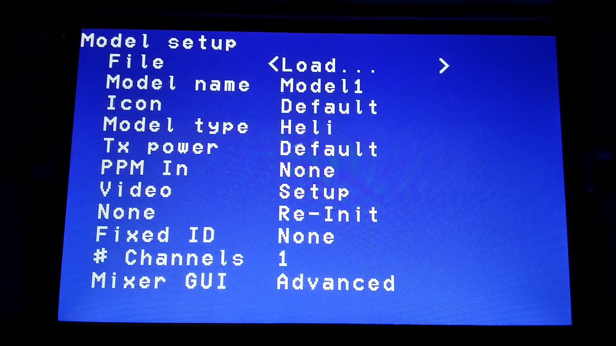

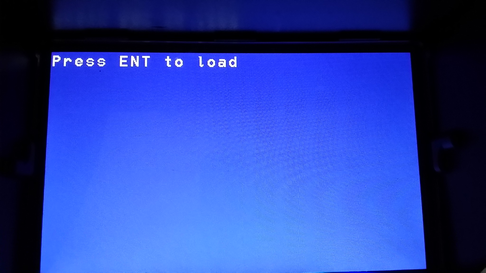

27 Jul 2015 00:03 #36102 by dc59
Replied by dc59 on topic Devo F12E Deviation Firmware ?
Hi PB,
I also meet a problem with my TX, my FS seems to be crashed suddenly, now I can't save anything,
and it's always like the picture below when I reboot my TX.
Every setting is gone.
I will try to reinstall FW again,if I get any clue, I will report it.
I will file a ticket for it, thank you very much.
