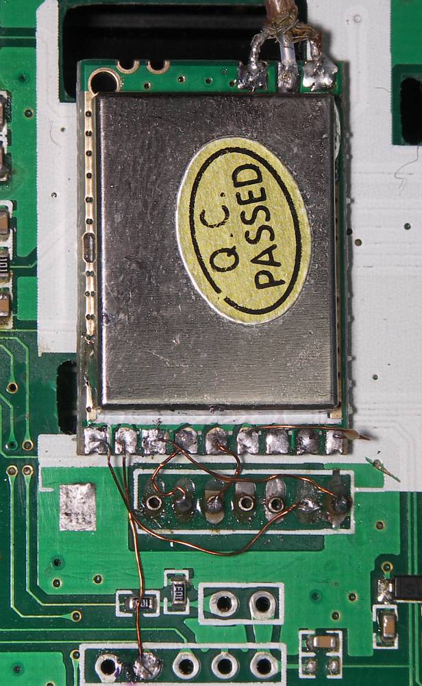

I postet a couple of days ago in another
thread
, so just 2nd try..
1. MCU swapped
2. TX module swapped, at the moment an A7105 is installed as told by FAQ
Deviation 5.0 nightly @ version silpstream doesn't recon my A7105 and cries for CYRF.. instead
What can I do?
1. MCU swapped
What can I do?

is tge cyrf module damaged? or have you shorted the wires going to it for the a7105?

Don't know... but there is no Cyrix module, after extraction I threw it away..HappyHarry wrote: is tge cyrf module damaged?
