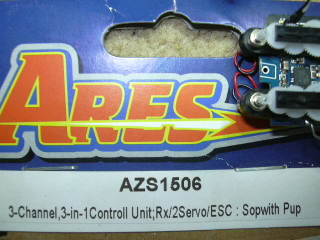

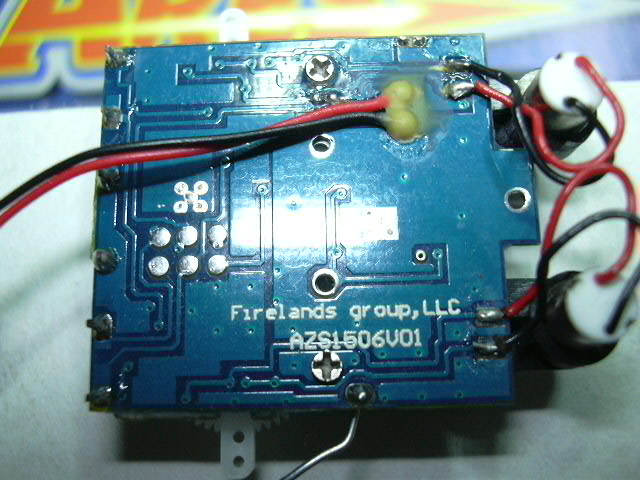

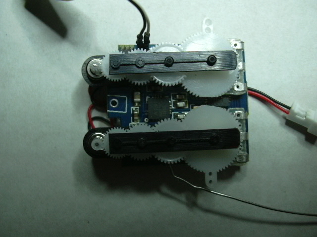

Hi all,
There have been many reports of people not being able to bind there Ares micros particularly the Fokker and Pup. I recently posted in one such thread as I "was" having same issue. deviationtx.com/forum/6-general-discussi...093-hitec-irm8#71442

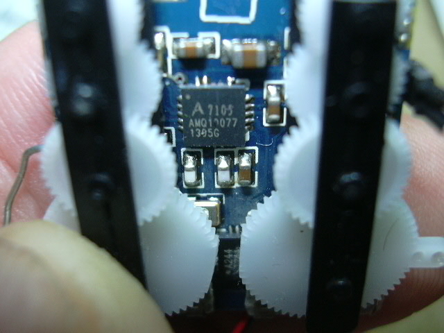

Today upon closer examination of Ares rx I noticed mine has an A7105 RF chip. not the CC2500 found on other Ares rx. What this means is the protocol for my Ares rx is different to others. This rx requires the Flyzone protocol, not the Hitec Minima protocol as used on other Ares rx with CC2500 rf chip.
The Flyzone FZ410 protocol is available on the MPM on RCGroups which I have tested and works. Would someone here be so kind as to add it to "Deviation with latest protocols" please. It would be much appreciated by many. I would like so much for it to be on my 8s.
