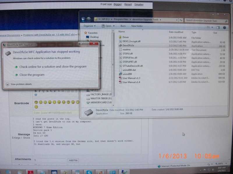

06 Jan 2013 17:11 #4742
by clearprop88
Replied by clearprop88 on topic Problems with DevoDfuSe ver. 1.5 with Win7 x64
I read the posts in the log.
I can't get DevoDfuSe to run on my computer.
I have;
WINDOWS 7 Home Edition
Service pack 1
64 bit OS
Intl i7 CPU
I tried the 1.4 version from the German site, but that doesn't work either.
It downloads Ok, and unzips OK, but when I try to run DevoDfuSe it just hangs up.
Any ideas?
I have;
Service pack 1
64 bit OS
Intl i7 CPU
Any ideas?
- clearprop88
- Posts: 94
06 Jan 2013 20:13 - 07 Jan 2013 16:19 #4744
by clearprop88
