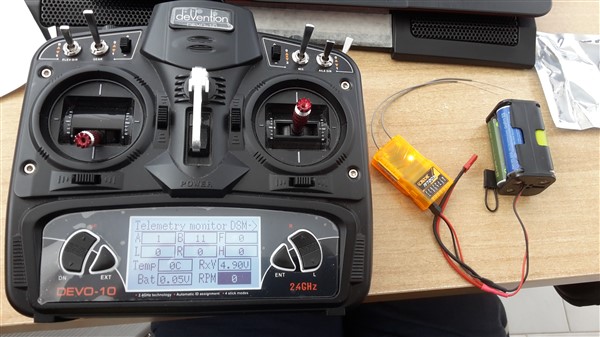

12 Jun 2015 15:43 #33925 by matrixFLYER
Replied by matrixFLYER on topic DSM Telemetry support
Thank You. I'm waiting the orange r720x with built in telemetry. I'll try with that since I don't have any other kind of receiver with telemetry. Thank you.

15 Jun 2015 07:00 #34102 by Thomas.Heiss
Replied by Thomas.Heiss on topic DSM Telemetry support
@matriyFlyer: HK does not announce FlighLog telemetry data for the orange r720x on its homepage product description?!
15 Jun 2015 22:16 #34140 by matrixFLYER
Thomas.Heiss wrote: @matriyFlyer: HK does not announce FlighLog telemetry data for the orange r720x on its homepage product description?!
I don't know. I just read the description but I can't find any "fligh log" in its description.

I just got and tested the R720X S.BUS from hobbyking. On my Devo I tested (bench test) indingo 10 May release and last nightly build. Both seems to work the same.
The receiver has 7ch pwm and 8ch sbus.
With dsmx and telemetry ON I can't get a bind with 7 channel. I can get a binding with 8ch on devo10.
With dsmx and telemetry OFF I can get a bind with 7ch and 8channel.
In all the cases I need to move one of the stick of my radio to complete the binding procedure.
With dsm2 I don't need to move the stick of my radio to end the binding process.
I will test this receiver in my mini quad with latest nightly build (19 of june) but I don't know what is the better binding.
Last edit: 26 Jun 2015 09:46 by matrixFLYER.

Do you get this behavior with the stock nightly builds.
Last time I looked, there were known issues in deviation as you go from 7 to 8 channels with DSM. For the most part, this is a minor matter, as binding with the maximum number of channels the Rx supports works, so you just do that. It's rare to need to bind with more or fewer channels than that.
The DSM2/DSMx protocols at some point changed to not complete the bind - the box about binding stays up, and the bind doesn't finish - until you move a cyclic stick. This is intentional. Could that be what you're seeing?

Yes it's that!!! Thank you very much. So I can be confident binding with 8channel and telemetry ON. (just for the dataport value I will not connect any sensor.)

I almost through a 620X into my last order from HK. Can you tell me if you're getting both signal strength (Fades, Losses, etc.) and Rx battery values from it's telemetry? Those are the only two I need from my Rx's - for now.

Everything is displayed. Even battery V and temperature if you put sensors.
