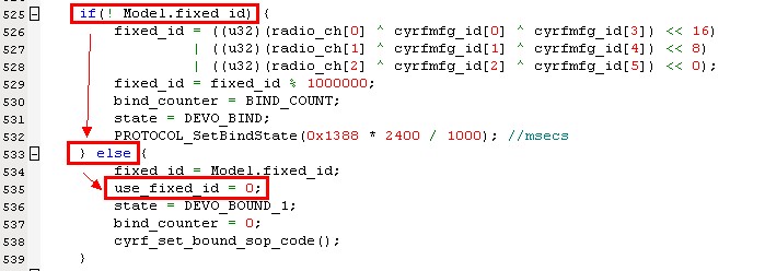

07 Mar 2013 21:45 #7498 by galee
As I metioned in the topic : www.deviationtx.com/forum/3-feedback-que...e6b-zip-doesn-t-work
DEVO7E seems something wrong about binding when use FIXID...
These days, I'm writing a Chinese Version for DEVO7E, the whole GUI is rewritten to reduce size, and the protocols is porting from PhracturedBlue's Deviation source.
When porting to devo.c (located at src\protocol), I found there may be a writing mistake:
I thought the code means when Model.fixed_id is zero, the tx will generate a random id and use_fixed_id will be zero (clear by initialize line 507), but when Model.fixed is set, use_fixed_id should be no-zero.
And there is another place make me confuse... function bind() line 491, is it mean whatever the Model.fixed is, the use_fixed_id is always 1?
Hope for answer~

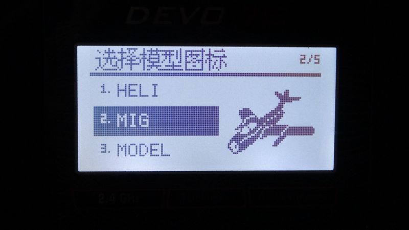

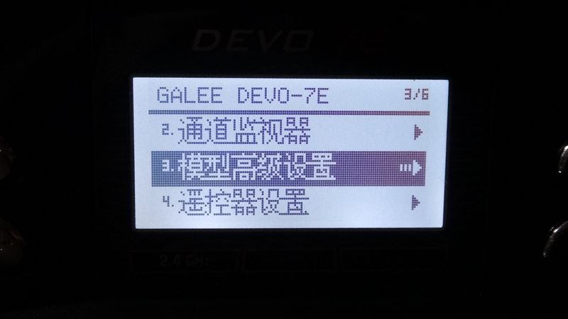

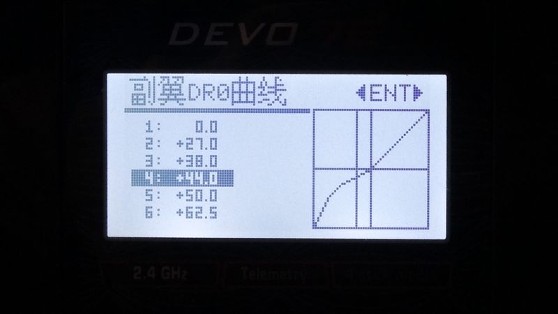

07 Mar 2013 21:53 #7499 by galee
here is some snapshot about the Chinese firmware, is there anybody can give me a Traditional Chinese 12dot font file? If has pls send to This email address is being protected from spambots. You need JavaScript enabled to view it. :P

try to clarify your confusion:
"And there is another place make me confuse... function bind() line 491, is it mean whatever the Model.fixed is, the use_fixed_id is always 1?"
if (PROTOCOL_AutoBindEnabled())
PROTOCOL_Init(0);
else
PROTOCOL_Bind();
and
case PROTOCMD_CHECK_AUTOBIND: return Model.fixed_id ? 0 : (void *)1L;
So which means bind function is only called whenever Model.fixed_id != 0
"but when Model.fixed is set, use_fixed_id should be no-zero."
It probably does not matter (though it is worth to make clear) for the value to be set here because bind function will set it to non-zero anyway.

08 Mar 2013 02:36 #7506 by galee
The deviation firmware does not support chs and cht because the flash size is small...
so I wrote another firmware, if you are chinese too, can visit 5IMX to get newest message. :P

08 Mar 2013 03:57 #7513 by PhracturedBlue
Replied by PhracturedBlue on topic Source code bug report about DEVO7E binding....
I can't help myself.
All that use_fixed_id does is select whether the upper nibble of pkt[10] is 0x00, 0x80, or 0xc0
From Devo.txt:
The upper nibble 0x00 corresponds to non-fixed-id, and 0x80 corresponds to using a fixed-id
An upper nibble of 0xc0 is used to indicate fixed-id binding is in progress
As you noted we should have set 'use_fixed_id = 1' when Model.fixed_id is non-zero. This bug has been there since last August though. Apparently Walkera Rx ignore the difference in this byte when using a fixed id.
08 Mar 2013 07:02 #7517 by galee
I have changed the code to '1', it still has problem when FIXEDID BINDING, after many times try, I found it do work if I insert 'initialize()' into the function 'bind()'....
it'ok now... but it seems not a good modification, the code can be more pretty...

08 Mar 2013 13:31 #7529 by PhracturedBlue
I'm not sure what the issue is, but my models bind fine using fixed-id on the 7e. Running initialize during bind should absolutely not be necessary,
