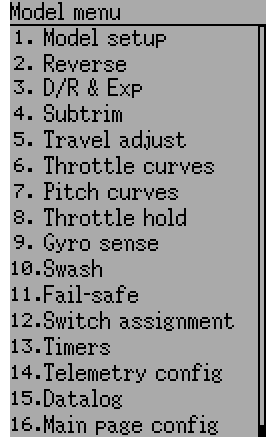

9.8. 标准模式¶
- Model setup: Model configuration page (See section 模型设置)
- Reverse: Servo reverse
- D/R & Exp: Dual-rates setup
- Subtrim: Servo sub-trim
- Travel adjust: Servo travel-adjust
- Throttle curves: Throttle curve setup
- Pitch curves: Pitch curve setup
- Throttle hold: Throttle-hold configuration
- Gyro sense: Gyro-sense configuration
- Swash: Swash Setup
- Fail safe: Fail-Safe configuration
- Switch assignment: Assign switch controls
- Timers: Timer configuration (See section 定时器)
- Telemetry config: Configure telemetry alarms (See section 双向回传设置)
- Datalog: Configure telemetry logging (See section 数据记录 Datalog)
- Main page config: Configure main page display (See section 主页面设置)
