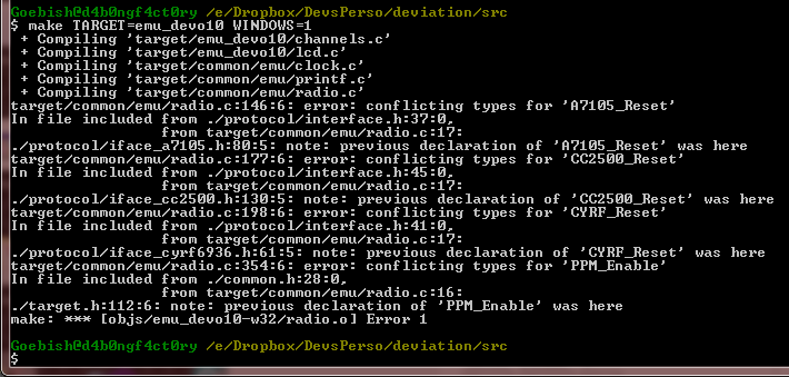

20 Mar 2015 22:09 - 20 Mar 2015 22:13 #29967
by goebish
Replied by goebish on topic WLToys V912/V915/? protocols
That should be enough, thanks
(maybe a capture in which you move the cyclic and give a bit of throttle could be cool too)
I'm trying to build the deviation emulator for Windows, that would be easier to check & debug things, but I'm struggling building it.
Is it a known issue, I've searched but not found anything ?
Last edit: 20 Mar 2015 22:13 by goebish.
