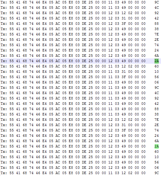

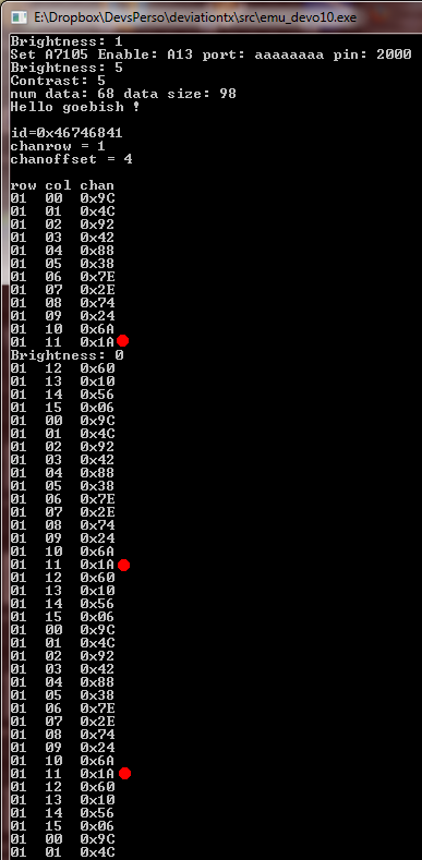

21 Mar 2015 02:44 - 21 Mar 2015 12:42 #29979 by goebish
Replied by goebish on topic WLToys V912/V915/? protocols
I compared channel hopping sequence from capture file with the one I have with the same tx id in deviation (emu) and there's a slight difference:
capture : 4C, 92, 42, 88, 38, 7E, 2E, 74, 24, 6A, 2A, 60, 10, 56, 06, 9C
dev emu: 4C, 92, 42, 88, 38, 7E, 2E, 74, 24, 6A, 1A, 60, 10, 56, 06, 9C
Maybe this can explain this copter (V912) does not work well with my latest firmware ? To confirm that I can build a dfu with this fixed id and hardcoded hops sequence to check if this fix the problem (after some sleep :p).
But this is only 1/16 packets... probably not enough to even notice.
Deal57, can you make a capture on the RX side ?(edit: maybe we can check a few other things before having do to that).
I've a problem with the 4 files you posted earlier, saleae logic software does not show anything when I open them. Which version are you using ?
Last edit: 21 Mar 2015 12:42 by goebish.

21 Mar 2015 14:58 - 21 Mar 2015 15:25 #29995 by goebish
Ok, that's cool but we're not done :p
Now we've to make it work with any tx id... I think I need to replace all the 0x1e with 0x2e in tx_channels[ ][ ] for this particular protocol (I wonder if this is intentional or if they made a typo when they coded their firmware , because that's stupid to change only 1 byte in the sequence)... or maybe that's more complicated than that in which case I'll need a few RX captures, to check which rf channels it listens on.
I'll build a few more firmwares you'll have to test ;)
Last edit: 21 Mar 2015 15:25 by goebish.
