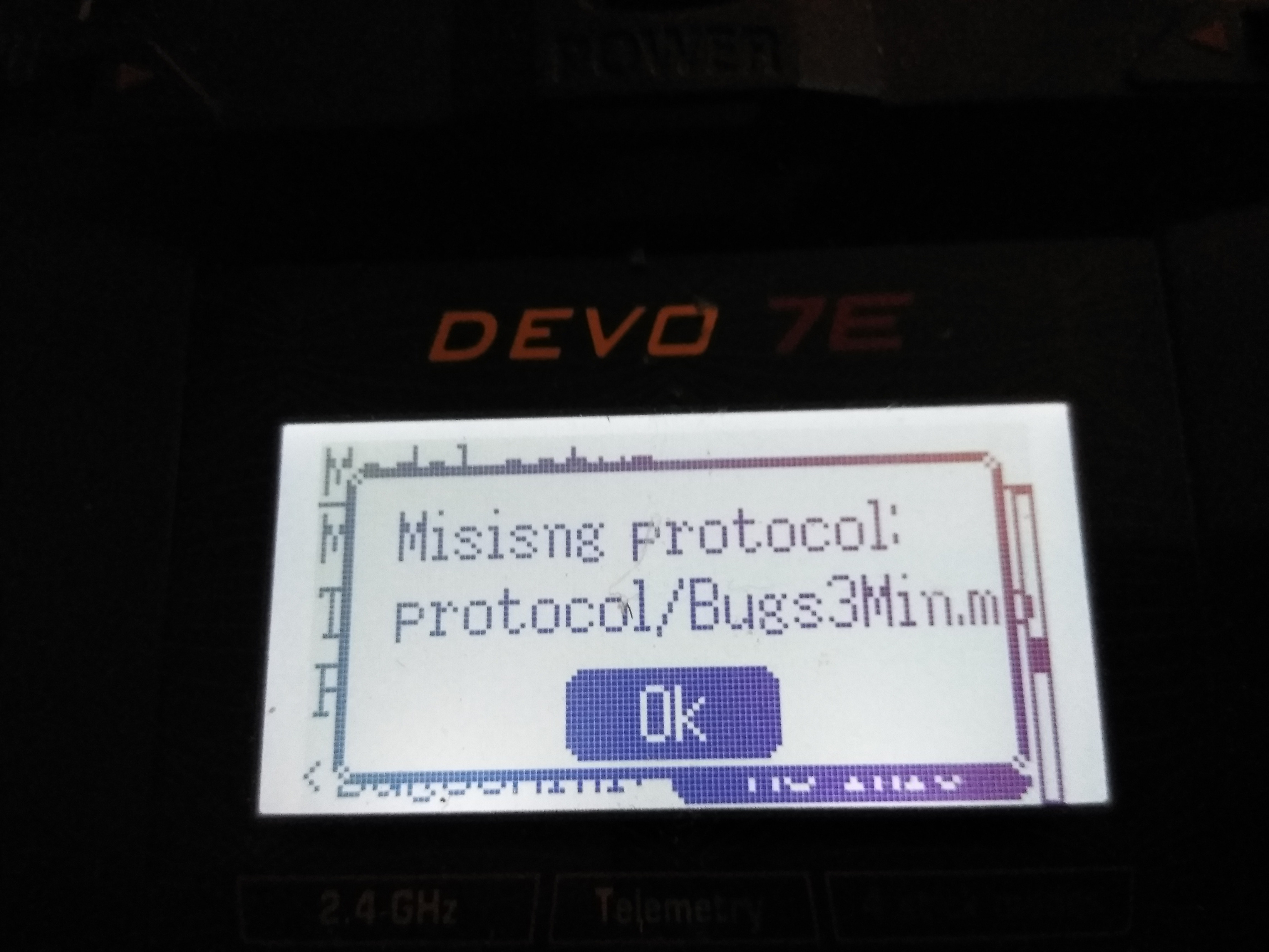

I tried on my devo 7E,no good missing protocol message appears.
Replied by C0ckpitvue 777 on topic Bugs 3 mini
goebish wrote: @DPyro, Added test build for 7e.
- goebish
- NRF Weirdo
- Posts: 2633
06 Oct 2018 13:42 #71200
by goebish
Replied by goebish on topic Bugs 3 mini
as often with my 7e builds ...
download the file again, it should be fixed (.mod file renamed)
- C0ckpitvue 777
- Posts: 409
06 Oct 2018 14:00 #71201
by C0ckpitvue 777
You are correct sir,I bound it to my 7E after re downloading file and channel 5 for lights,awesome job...
goebish wrote: as often with my 7e builds ...
