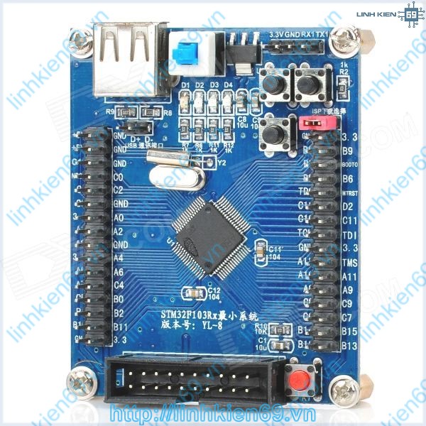

I use Kit stm32f103rbt6 ,, a Usb FTDI .
I set boot0 =1 ( 3V3 ) Boot1=0 )
load bootloader 128k by Flash loader demontrate , choose 128k . instead 64k
Load ok , then i set boot0 = 0 . i connect wire pin C9 to B8 ( BUTTON MATRIX ) to create button EXT ,
connect 2 pin USB stm32f103 to USB, turn on power .My computer don't detect any new harware USB .
Then i use DFUSE , it also don't dectect devo 7 . e

That sounds about right. Only 3 things i can think of:
1) set boot1=1 and boot0=0
2) check that you are flashing to 0x08000000
3) try connecting directly to the usb port on your board, cause i can't tell which side of the 2 resistors the 2 pins d+ and d- connect to on your board.
You don't need to mimic EXT after the first time you flash the bootloader. It will drop to dfu if no firmware is loaded at 0x08003000.
Last edit: 28 May 2016 19:16 by silpstream.

i set boot1= 0and boot0=1 when load bootloader and set boot1=1 and boot0=0 to run.
.connect direct to pin usb stm32 , still not change .

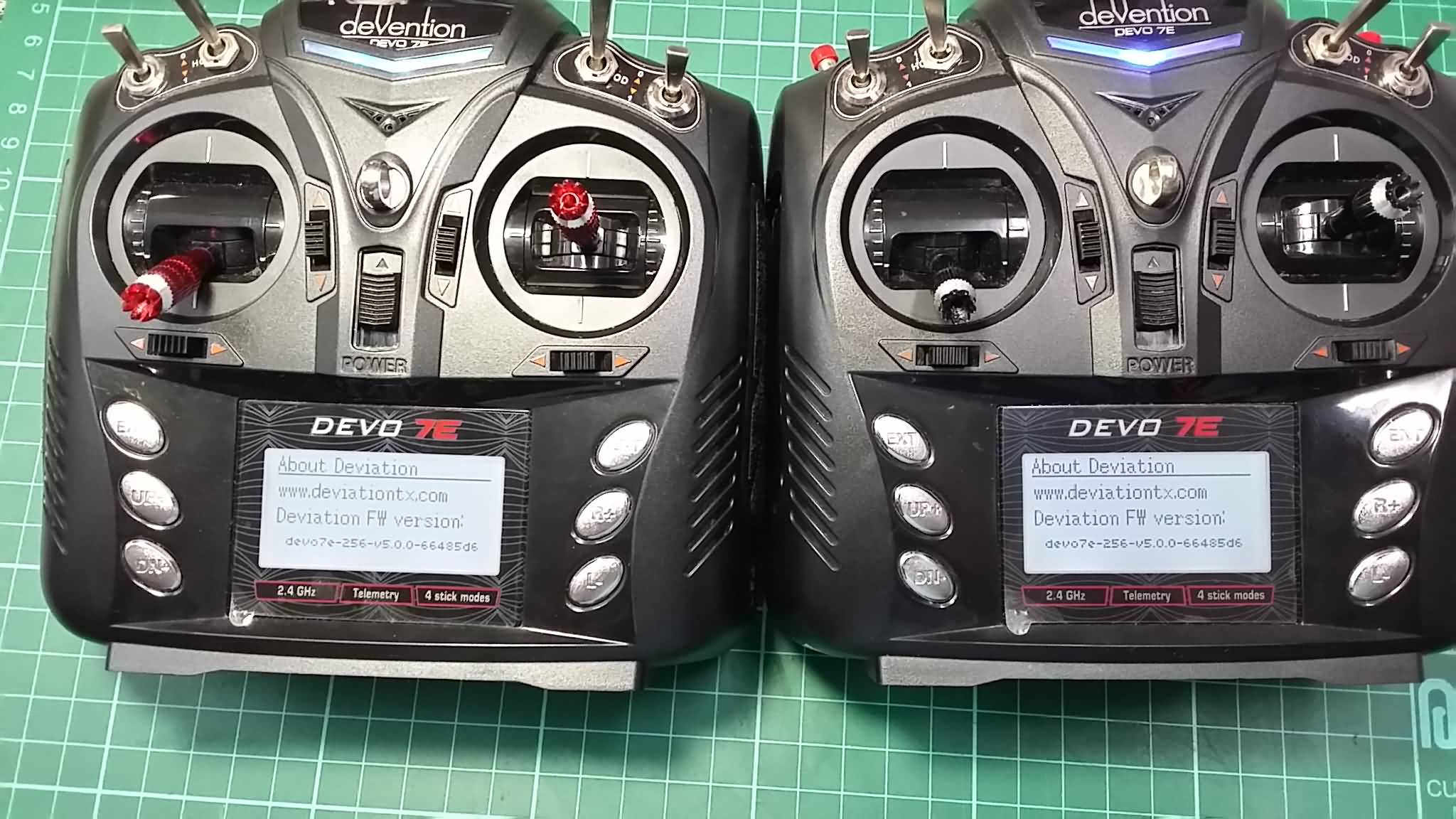

Finally , I got my 2 DEVO 7E with new brain (STM32F103RCT6)!!
Thanks for silpstream's tutorial and now running HappyHarry's test build.
