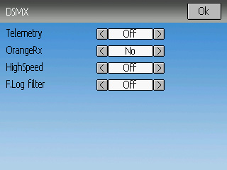

18 Oct 2016 05:41 - 25 Oct 2016 04:35 #55082 by vlad_vy
Replied by vlad_vy on topic Deviation v5.0.0 build with latest protocols
Added DSM2/X protocol option "F.Log filter", by default "Flight Log" filtering is disabled.
P.S. I can't fit "Flight Log" filtering to devo7e build, so it cut out from code for Devo7e (Devo7e-256). Sorry...
(18.10.2016) Firmware DFU file only, you can get other components from official v5.0.0 release.
www.deviationtx.com/downloads-new/category/398-deviation-5-0-0
Files deleted, see below
Last edit: 25 Oct 2016 04:35 by vlad_vy.
